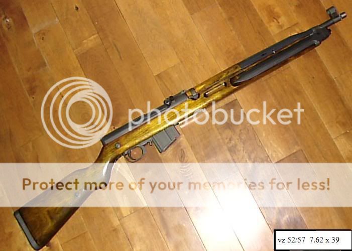

m39a2 said:
They are perhaps the most overbuilt rifle ever! Far heavier than required in every respect than required for the cartridge. It uses the fire control system of a Garand/M-14 and I'm not sure if the gas system is home grown or not but it is unique. It even has an adjustable gas system but you have to take apart the whole rifle and use a big wrench to do the adjustment. Try to stay away from corossive ammo if you can, the gas cylinder is a pain to clean!!

Myth: "The VZ-52/57's gas system is a ##### to clean"
Reality: It is very simple
IF YOU ARE FAMILIAR WITH IT
The gas system is one of the reasons that rifle is so accurate: it is concentric with the barrel's axis and doesn't exert any torque on it when ejecting.
The other one is the rifle's adjustable bedding tension.
Cleaning it is a real snap: take the upper cover out by pressing the catches near the rear sight and pivot the cover towards the front while pulling it back a tad.
Take the magazine out, too.
Now, take a loaded round and place the tip of the bullet in the hole at the base of the bayonet blade and push while sliding the barrel retainer towards the front sight.
Once done, lift the muzzle of the rifle up and all the rifle's mechanism will lift out of the stock.
Put the magazine back in the action and lock the carrier to the rear.
Push back the small tubular piston at the front, hold the U shaped channel that connects the annular piston and the secondary actuator (the part that pushes on each side of the bolt carrier) and separate the piston and the channel. The piston is now free to slide down the barrel and you can clean around it. Scrape the inside lip of the piston and pass a Q-tip saturated with nitro powder solvent in it.
Wipe the steel U shaped connector and all these parts and you're done. See? Easy!
Note: In front of the piston and gas hole, there is a ring bolt with another behind it. This bolt regulates the gas chamber volume and thus the push on the piston; the other one is the adjustment locking bolt.
