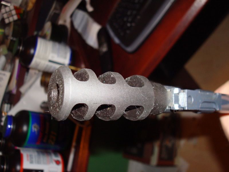

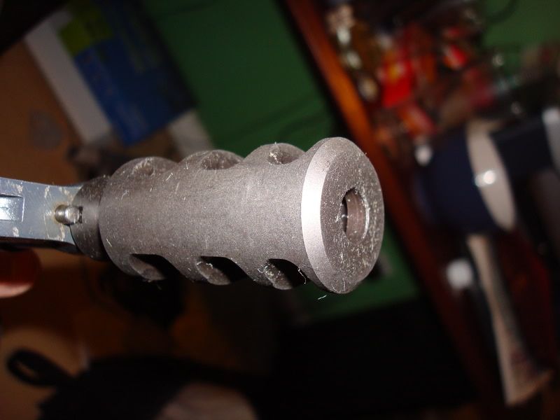

I got mine in the mail recently but is it normal for the top of the break to have less slot cutout than the bottom, to me this would cause for muzzle rise. Was it machined wrong? What are yours like. Mine measures approx. .575'' on the top between the side ports and .370'' on the bottom between the ports.
The first pic is of the top of the brake, the second is of the bottom
Should the narrow part of the brake not line up with the cutout for the stop pin?
Can you put a washer on the thread to 'back it off' a 1/2 turn? Or file some metal off to make it spin an extra 1/2 turn?
My brake on my 58 didn't fit exactly either - I had to file a few thou off... go SLOW - a little goes a loooong way!
edit: nevermind - I see you only have one slot in your brake... mine had two... different brake I see..
??? looks like the slot is on the wrong side
It has to be exchanged..... I'll send you another one and postage for that one ...... must have been a Friday
