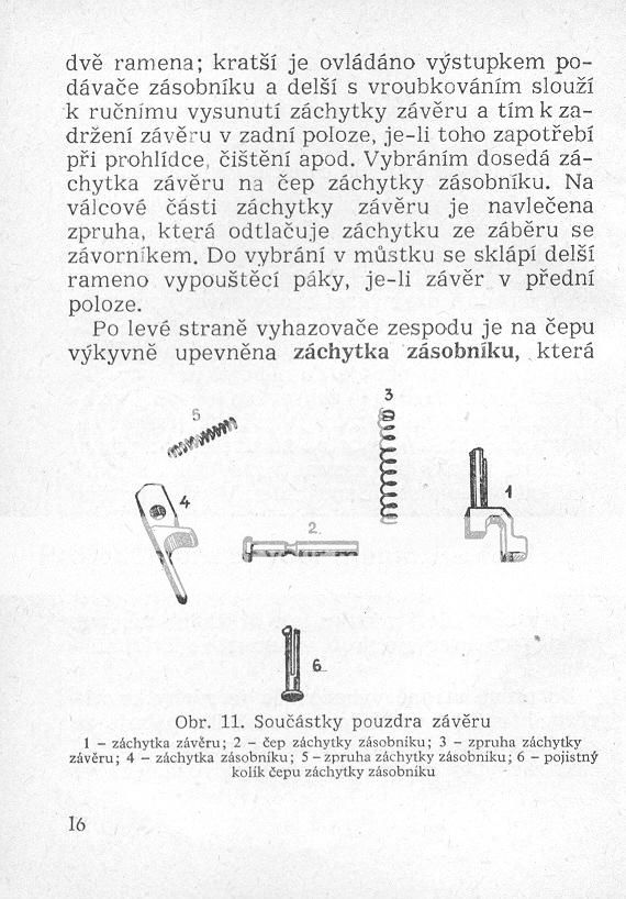

I just got the extended mag release from GP Tactical and was looking for some instruction on how to instal the thing.
Also anyone know how to install a pistol grip on the VZ-58? I assume when I strip it, it will be obvious, but since I'm already asking.

mag release:
1) you must remove the safety pin (marked 6 on the picture) ... it has a little catch from the inside. Use screwdriver to push off the catch and than you can push the safety pin down.
2) now you can push out the main pin holding the mag and bolt release (marked 2 on the picture). Be aware ... both mag and bolt releases are on a spring, so they'll pop out of the gun if you won't hold them :)

mag release:

Nice find!
I'm trying to install the handgrip and the thingy the screw goes into moved, how is it supposed to go?
