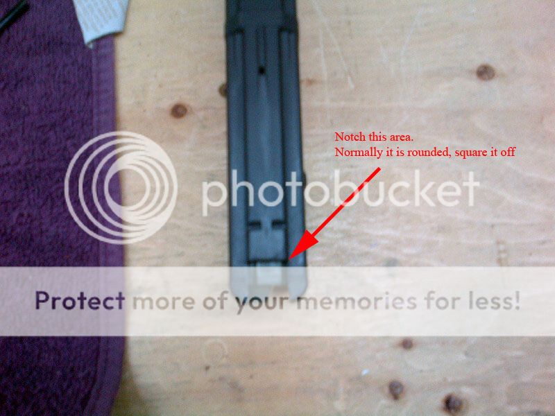

You don't have to buy anything. I just tweaked my 2 VZ with CSA mag well adapter to work with pmags and it always holds open on the last round. I will take a couple of images and send to you, what I did.
You will have to "notch"out the back of the pmag a little, more like square it off (will post image). Even with mod the mag still works fine with the AR. This allows the mag to sit fully into the CSA holder.

Below is the modification to the pmag, this can also be completed if using a metal style mag (just makes the mat'l removal little harder). This will allow the bolt catch to contact with the mag follower. Also allows the mag to fully seat and lock into the mag well.
