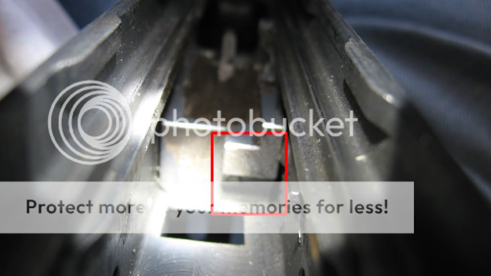

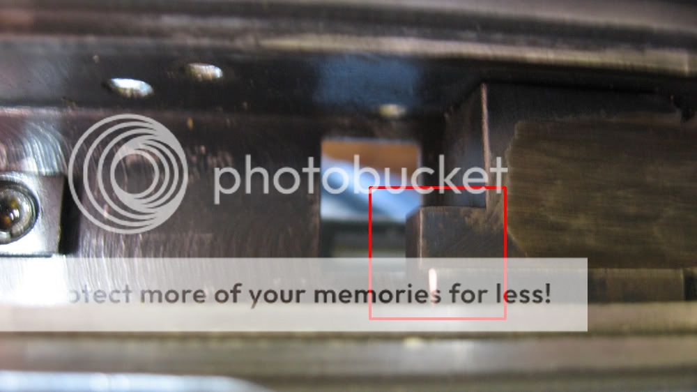

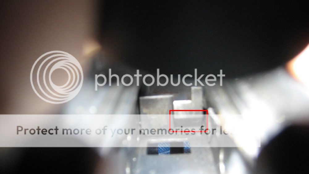

I think this is screwing up my trigger(the only part, beside the bolt carrier, which won't just 'drop in')
The rectangle on the right side of the trigger, that is kind of separated from the rest of the trigger, is supposed to(i guess) fit right in where that slope is under that extended piece of metal.
But since it's sloped, and not a 90° cut, it's blocking the trigger from fitting nicely. And so I can't get the trigger pin in, which makes me unable to get the sear pin in. Otherwise everything else seems to fit snugly.
Yes that is stopping the trigger assembly . The trigger assembly in the cz858 parts kit from Wolverine will not even fit in a cz858 . Those parts kits are military surplus parts.
The cz858 & the Marstar vz58 are modified differently & you will have to modify the parts in the kit to fit . If you modify the receiver you run into legal issues
Think I can just lop off the little rectangle on the trigger then? Or do I need to be patient and shape it.
The trigger in the parts kit has 2 arms that work on the safety that operate the sear . the one on the left is for S/A the one on the right is for F/A that is why the block is in the receiver to prevent the F/A you will need to remove the right one & grind down that side of the trigger to fit . also the kit obviously comes with only the S/A sear so you need to make a spacer for the sear pin to keep the S/A sear from floating on the pin . Look in the milsurp section there is a sticky on VZ 58 questions & there are some good pic's of a CZ 858 trigger assembly & receiver & you can see the difference in the receivers
