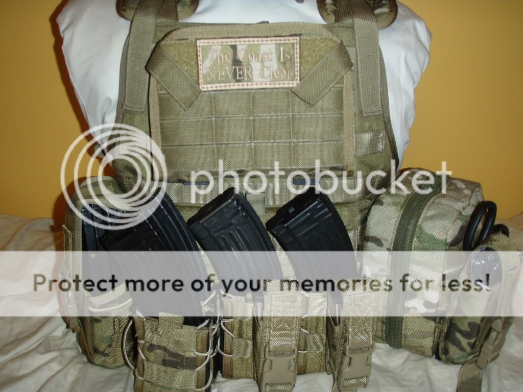

Random netpic...
This one is upside down so... watch lots of vids I guess.
Full mags should look to the left with rounds down. Pic above is good for the lefty. On the belt, just follow the same logic - should look back if on left side.
