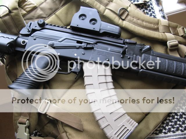

I am hoping someone like NEA or BC Tactical will be able to come up with a railed received platform similar to that which Krebs Customs offers for the AK. It would enable the user to have a #### pile of options as far as mounting scopes or RDS options and allow flexibility for varying eye relief requirements.
The Krebs AK rail runs from the rear of the receiver, over the dust cover and bolt and appears to taper in and is pinned where the front sight would be. Then a low-profile rear sight is incorporated into the rear of the rail that allows use of the factory front sight. Built in irons, no need to add flip up sights.
I tried to attach a link to Krebs receiver rail but it didn't work. It's under their product page in any event.
I realize the AK dust cover runs the entire length of the receiver, but I don't think a full length receiver rail will be an issue with the VZ58, especially if a relief taper were incorporated over the bolt to ensure no issues with ejection.
I've looked a lot at the NEA cantilever mount and gas block rail, but the mounts put everything up way too high for my liking, especially to use standard flip type back up sights. Its a great idea, but to me its half finished!
Looking for feedback and hoping there is a shared interest there to get such a project on the move.

That is the receiver I was referring to, thanks for posting.
I believe the Krebs style of mount is pinned to the back of the receiver and the front sight mount, not the dust cover itself, so in theory it should be stable enough.
