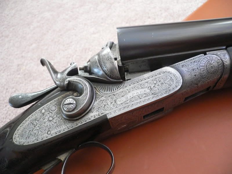

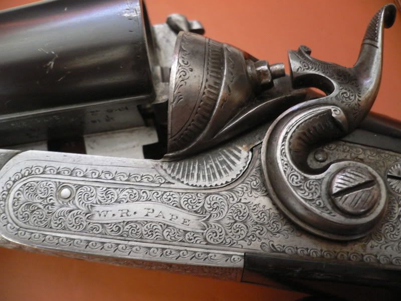

Looking for info on an old Pape 12ga. Its a large action with 3 inch chambers. Barrels are 30.5" long and 3/4 choked. The gun weighs 8lbs.
Is Newcastle-On-Tyne considered a Birmingham gun? The proof-marks are Birmingham. There is SUP with 2 crowns over it, 12-76 and also 850 Bar. There is also a R with some symbol over it.
Any help will be appreciated. I have posted on a few other forums and will share any info I get.Thanks.

The twin crown over sup is British. It is the mark for magnum proof , I think it is over 19000psi.
It was re-proofed in '91, hence the Birmingham S X C, and what I read as a 5 below the crossed sword, would be inspector #5. The 850 bar (12 328 PSI) is the standard test pressure and was added in '91, prior to the SUP "Supplementary Proof" at 1200 bar (17 405 PSI).
The 3" rechambering must have been done just before it was re-proofed.
BTW this gun was NOT proofed for Steel Shots (would have get a Fleur de Lys stamp if so).
This gun bares a real history of proofing....
Really, really nice gun.
Thanks Baribal for the info.
There is also the 12 LC mark which makes me think the gun originally with long chambers. I have a w.j. Jeffery hammer live pigeon gun which originally came with 2 3/4 chambers but it only has a 12 C in a diamond mark.
