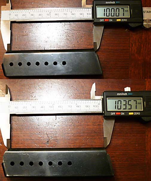

Take it out to measure, and sure enough, the height of the magazine body is 2 or 3 millimetres shorter than the ones which work just fine. Look pretty near identical, otherwise.

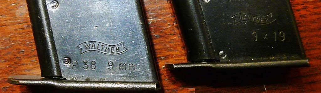

The ones I have that work are marked with the Walther logo, then P38 9mm. This new one is marked in the same place Walther 9x19. No other markings, such as on the base-plate, aside from some have a serial along the back. All hold 8 rounds of 9mm Luger.

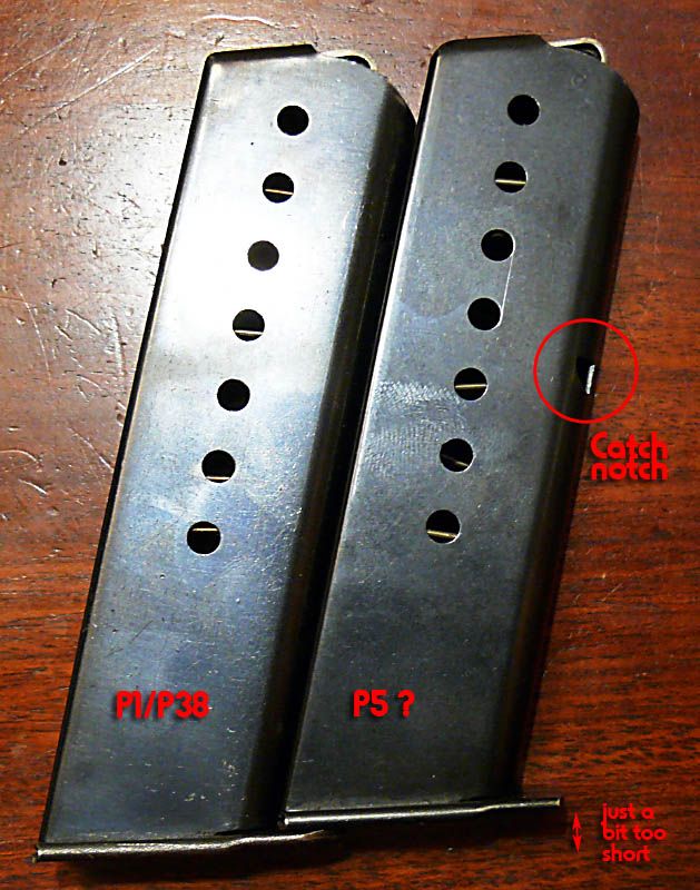

One other difference is the new one has an extra notch half-way up to act as a magazine catch.

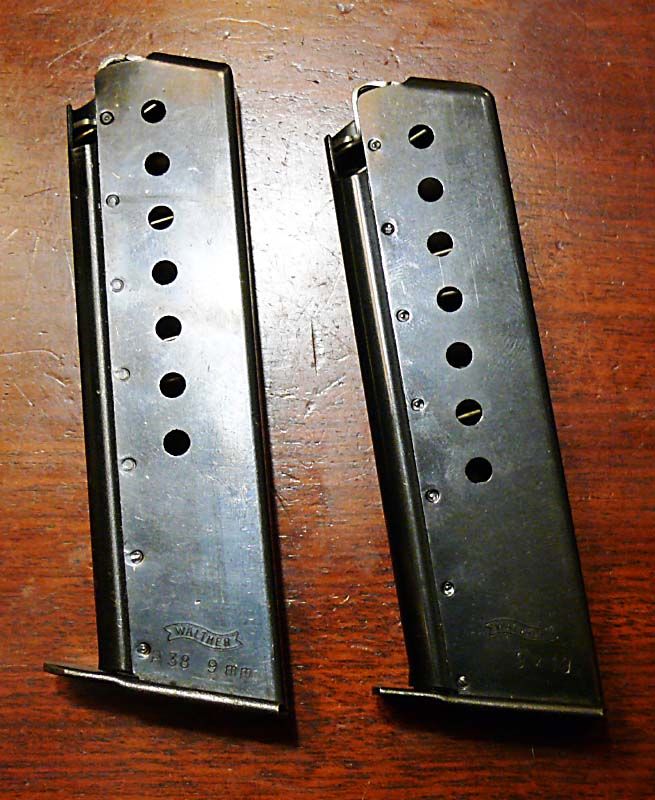

Yep, here's some pictures:
Working P1 magazine on left, mystery mag. on right.
Only markings.
Length difference (other dimensions reasonably identical).
I labelled some stuff.

I agree with "elektrobug". The mag appears to be a P5 Compact mag. The P5 Compact had a button release behind the trigger for the magazine.
Okey dokey, it does indeed appear that I was sold a Walther P5 Compact magazine, mistakenly mis-identified as a P38 / P1 mag. Nuts.
As I understand from my over-night Walther pistol variations expert course, the mag.s for the P5 and P5C are dimensionally the same. Functionally the presence of the catch notch means it can be used in either model, whereas a missing notch would preclude compatibility with the thumb release types. Any dissenting opinions?
