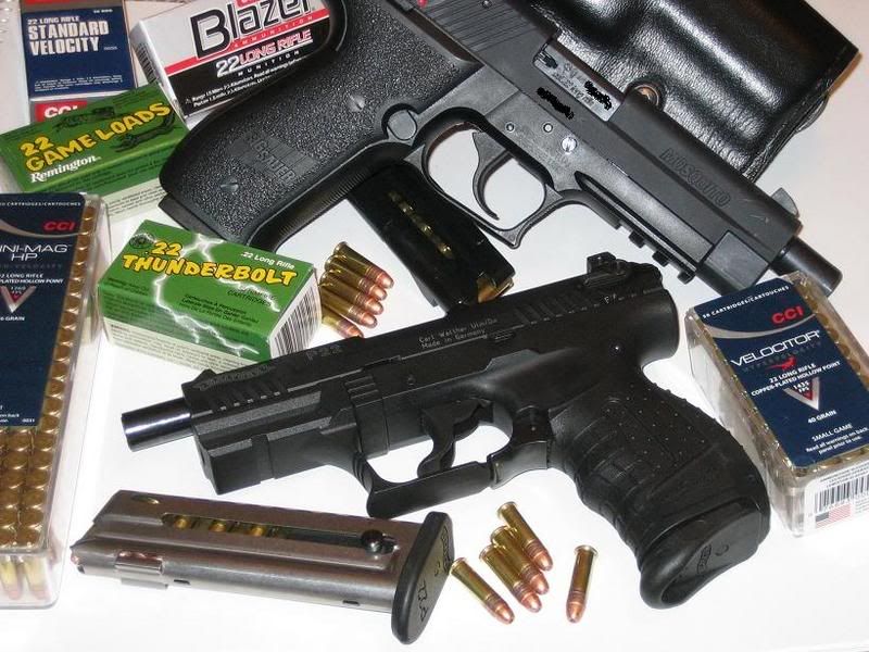

My "Guns & Ammo" style composition :D

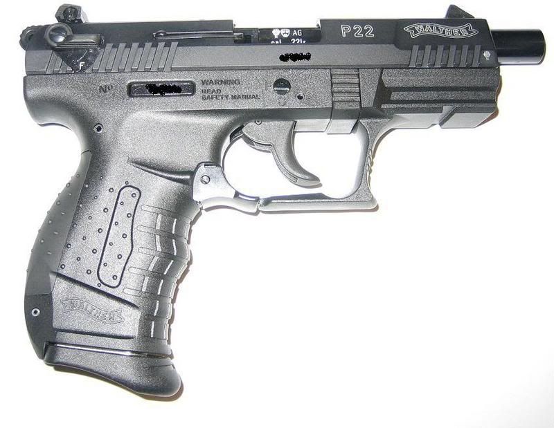

My modified P22 with a 106mm barrel:

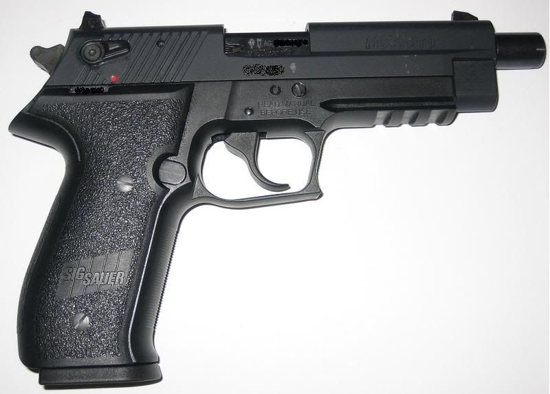

My SIG Mosquito. The black model with the threaded barrel is the only model being imported into Canada at this time as far as I know. The barrel is about 121mm. Breechface to the end of the slide is just shy of 101mm, so with some gunsmithing you could get it to look very similar to the U.S. model, where the barrel is 3.98 inch or something like that (about 101mm).

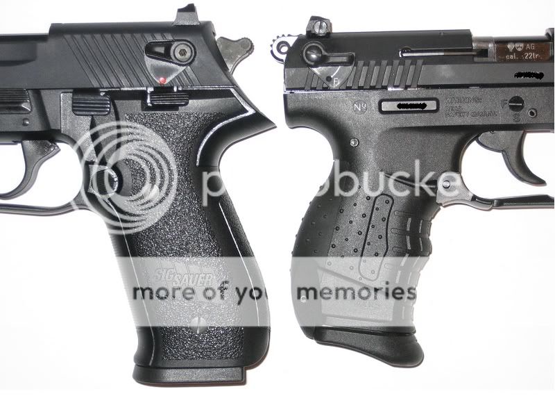

Size comparison of the grips:

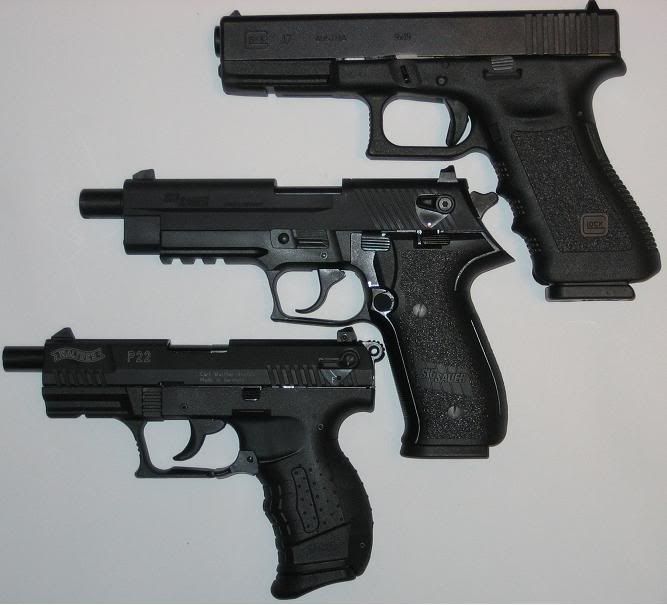

Size comparison with a Glock 17:

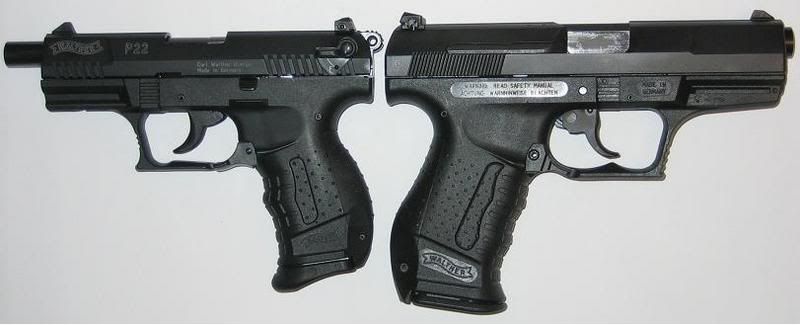

P22 with its big brother, the 9mm P99. Note that the P99 is a near perfect fit for my hand.

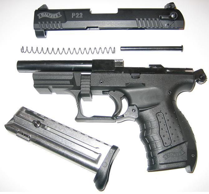

Walther P22 field stripped:

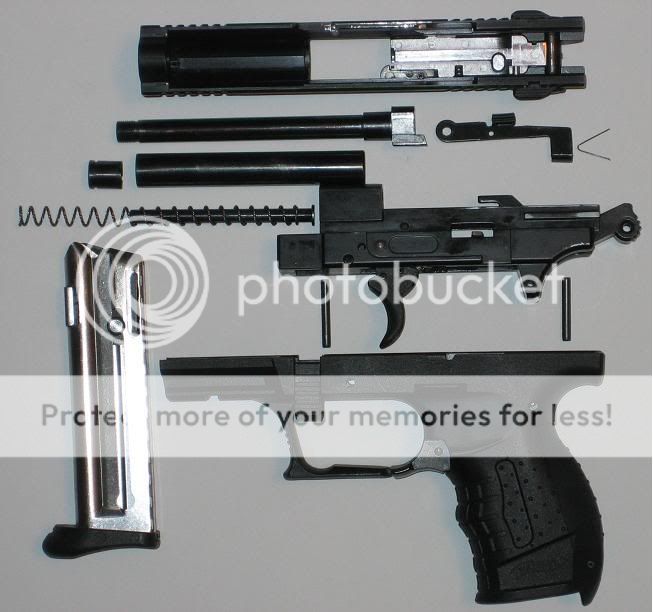

Walther P22 about 50% disassembled:

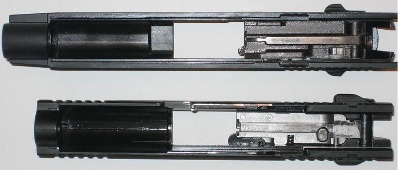

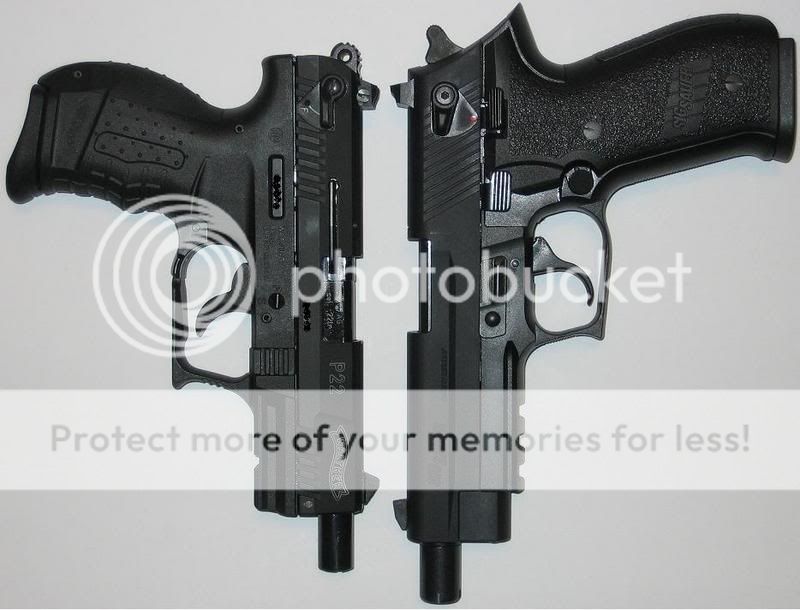

Comparison of slides (SIG on the top):

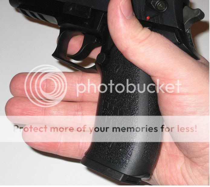

Size of SIG Mosquito grip in hand:

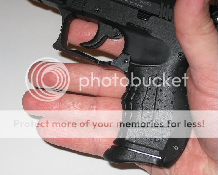

Size of Walther P22 grip in hand:

Looks to me like you got one from a "good batch"
the "AG" on your ejection port states that it's a 2006 model, apparently anything before 04 is bad news.
Also, you have "A-Suffix" mags, A - for advanced... Walther tweaked them as the old ones had alot of trouble with the semi double stacking and rounds not being picked up during a cycle.

ghostie - can you please tell me how the hell you got that front sight in the P22? I've got it as well, and I can't get the little piece out, it feels like if I pry it anymore, It will break and I'll never get the sight in there. Can you tell me how you did it? Thanks in advance.

Just take the slide off. Then take a screwdriver and push the sight off from the bottom up, i.e. from the inside of the slide. Don't gouge it but just use a strong pushing motion. The base of the sight has two prongs. Squeeze them together and push the unit in the hole.

Excellent pics man, thanks, I 'am shocked at the size of those:eek: Or do you have monster mitts? :D Great post:cool: Sig looks great
I'm a bigger guy (6'3", 215lbs.) but I have average size hands. Glock 17, SIG 226, etc. are a good fit for my hands. Glock 19 is getting a bit small for me. Yes, the pictures tell the story... the Mosquito grip is about the size of a Glock 19 grip - when you wrap your hand around it there is no gun below your pinky, and your pinky is completely covering the front of the bottom of the mag. The P22 is freakishly small compared to pretty much every other gun still being imported into Canada these days. For some weird reason it feels too small when you just handle the gun, but when you are shooting (with both hands) you don't notice it so much. I commonly forget that I am shooting with the shorter of the two mags the gun comes with (the one without the finger groove).

Nice pic. I ran mine like that - with the 5 inch barrel - for awhile. I think that is the best thing to do if you don't want to go through the process of shortening the barrel. The "compensator" started moving on me the first time I took it out, and this seems to be the common experience of all P22 owners in Canada. You don't really experience the fun of this gun until you ditch that dumb compensator thing and move the front site onto the slide (which can be done in 30 seconds).
I had the barrel shortened to 106mm (just over 4 inches, minimum length it can be shortened to without re-registering the gun as a prohib) from the stock 5 inches (127mm). The work was done by Barry Jensen at Bits of Pieces in Delta (/www.bitsofpieces.com/). Cost was something like $70 plus tax. The only downside was that I didn't have the gun for most of last summer, as Barry is very busy and he likes to do his lathe jobs all at once.
There are two ways you could change it. If you look at the disassembly picture you will see that the barrel is a skinny thing, and then there is a barrel sleave (which is just a black tube with a notch in one end) that goes around it. One way of doing it would be to seperate the skinny part of the barrel from the chamber, then cut the barrel and reattach it to the chamber. You would then just have to cut the barrel sleave to the right length and put a new notch in it so it clicks into the frame of the gun. This way you would keep the stock "end cap" on the barrel and you could continue using the stock wrench to disassemble it. The down side of this is that it is more work, probably more risk (making sure youhave the barrel attached to the chamber properly), and if you cut the barrel from the back end, you will cut off most of where the barrel is marked "Walther .22LR", which some people want to keep.
The other way of doing it is the way mine was done. You don't have to seperate the barrel from the chamber, you just cut the front of the barrel off to 106mm, then you thread the front of the barrel with a lathe, and you make a threaded "spacer" thing that threads onto the front of the barrel and holds it tight with the barrel sleave (which also needs to be cut, but just from the front end, so it doesn't have to be re-notched). This way cuts off the stock front end cap, but it has the added effect of making the barrel look like a "real" 9mm-type barrel (it is actually skinnier though, it's probably more like a .32 or .38 barrel), becasue there is no "end cap" on the front. The way you tighten it together is - the spacer thing is notched on the front (like the head of screw sort of) and you can screw it in with a quarter or with any flat object that is the right size. I use a quarter and that works very well. When it is tighened up, there is no movement in the barrel or the sleave. It's really an ingenious way of doing it. Barry Jensen did an awesome job. I highly recommend this guy for tricky conversion jobs and stuff that requires some original thinking.
