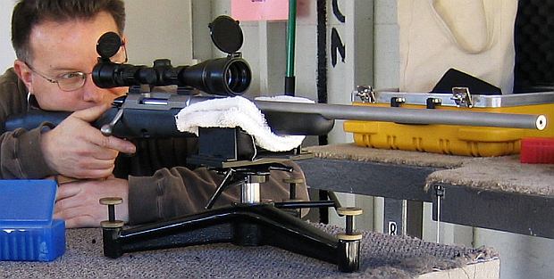

I sent the barrel and barreled action to Kevin and in a very short time it was returned. Kevin did a perfect job on the rifle. I had asked him to try to match the bead blasted finish of the Tikka when he finished the new barrel. It came out perfect and the only way one can tell it is a custom is the extra two inches of length and the "20 Practical" cartridge designation.
So, no doubt you're asking "how does she shoot?" Is my "prototype", first-ever 20 Practical an accurate rig? In a word, yes. Even with the standard factory stock, and light contour barrel, it can shoot 3/8" groups. Take a look at the typical target from this rifle. This is from an 8.5-pound sporter with a very skinny fore-end and a factory trigger.

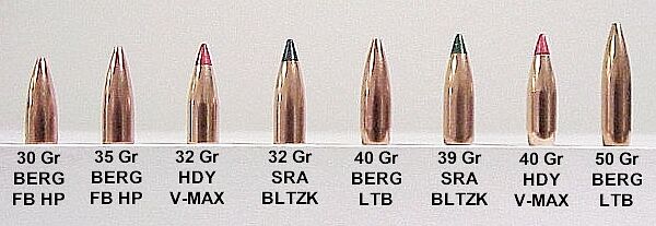

Warren's Load Notes: My pet loads are all with IMI cases, 32gr Hornady V-Maxs, and Fed 205 primers (not match). These are the most accurate loads in my rifle so far. I haven't even bothered with the 40s as I have the 20 PPC and 20 BR for those heavier bullets. I prefer the lighter bullets in the 20 Practical because I wanted to keep speed up and recoil down in this sporter-weight predator rifle. Also, the 32gr V-Max is exceptionally accurate and explosive. I like N133 the best as it burns so clean. IMI cases are tough and well-made.
Kevin's Load Notes: I used Remington 223 cases, Hornady V-Max bullets, and Remington 6 1/2 primers to develop the above loads. CAUTION: all loads, both Warren's and mine, should be reduced 20% when starting load development in your rifle. All load data should be used with caution. Always start with reduced loads first and make sure they are safe in each of your guns before proceeding to the high test loads listed. Since Weaver Rifles has no control over your choice of components, guns, or actual loadings, neither Weaver Rifles nor the various firearms and components manufacturers assume any responsibility for the use of this data.

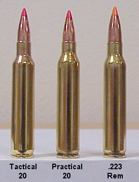

Comparing the 20 Practical and 20 Tactical
Kevin tells us: "The 20 Practical and the 20 Tactical are almost identical cartridges. There are only slight differences in case Outside Diameter, shoulder angle, and case body length. The neck length on the 20 Tactical is a bit longer, but there is still plenty of neck on the 20 Practical to grip the popular bullets, such as the 32gr V-Max. Here are some specs:
Cartridge Bolt face to shoulder Shoulder O.D. Shoulder Angle Total length
20 Tactical 1.5232" .360 30° 1.755"
20 Practical 1.5778" .3553 23° 1.760"
Both the 20 Tactical and the 20 Practical are fine .20 caliber cartridges. At present, the 20 Tactical is the more popular of the two because it has had more publicity. However, my favorite would be the 20 Practical. Warren's 20 Practical gives the SAME performance as the 20 Tactical without fire-forming, or having to buy expensive forming dies. So with the 20 Practical you do less work, you shell out a lot less money, yet you give up nothing in performance. What's not to like? To create 20 Practical cases, just buy a .223 Rem Redding Type "S" Bushing Die set with a .230 or .228 bushing and have fun with this great little cartridge."

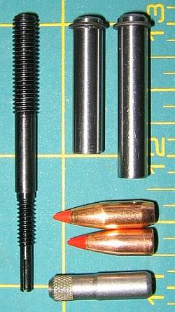

The photo shows: A) the two different length .22 seater plugs for the Redding Competition Seater; B) the short 17 Mach IV Type-S decapping assembly used in the 20-221, 20 PPC and 20 BR; C) a .20-cal button; and D) two Hornady .20 cal V-Maxs. Parts List: Redding Part # 10715, decapping rod stem for bushing neck die (short) $4.00; Redding Part # 42203, .20 caliber size button $4.00; Redding Part # 55042, BR seat plug for .22 cal (long) $21.00.
As for the seater, I use Redding's Competition seating dies for all of my cartridges. You can also use just about any other brand of seater. But I have noticed that Redding's Competition seaters give very repeatable results. I have also noticed that these seaters have given me the same consistent results when using them on my .20 calibers even though they were intended for the larger parent calibers. The .204 caliber bullets engage the .224 seater plugs very well, perfectly seating the bullet in terms of straightness going in and concentricity of the final loaded round.
