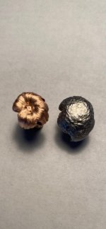

Yeah I'm to cheap to buy some of those gel blocks so I used washer fluid jugs filled with water.
I tried two types of 6.5 cm ammo, first was 130 gr Terminal Ascent and the second was 120gr ttsx. Both slugs were captured in the 5th jug.
But the T/A's did split the 6th one but stayed in the 5th. Both mushroomed perfectly and I was kinda surprised that no petals broke off the ttsx, it held together pretty darn good, so did the TA's.
The TA's had a larger frontal diameter than the ttsx as you can see in the pics and I think I'll use the T/A's for hunting.

Please test the Oryx ! An fusion for that matter. Both bonded ay!?
Thanks for posting your results.... The TA , it's a bonded bullet by the looks? Not familiar with it
I loaded some 44 magnums and shot at 4 water jugs a few weeks ago trying to test expansion of the bullet.... all jugs split and destroyed and couldn't locate the bullet. I assume the milk jugs are too thin plastic and split too easy. I'm continuing to save some milk jugs in the shed to try again since we empty a milk jug every few days compared to washer fluid jugs every few months
Great post...LOVE IT ! Great performance on both, but I like the "shroom" on the bonded bullet much better !!
