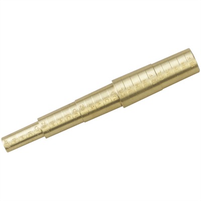

As it turns out, steel shot doesn't require as much choke constriction to produce the same pattern at the same distance. So one option is to open up the choke(s) to "modified" or more open than that for closer shots. This allows for the use of steel shot shells through guns that were never designed for it. This is feasible with most shotguns made from about 1910 onward.
To do this safely, though, you need to know the actual amount of constriction as compared to the nominal bore - at a minimum after the reaming is complete, if not before starting, too. Simply knowing that a dime will fit through the choke doesn't tell you how much diameter is lost going through it. Two guns could have a muzzle opening that fits a dime exactly. But, if one has a larger nominal bore, the blocking effect on a shot stream of steel shot passing through it could be disastrous, whereas the other may be just fine because the shot stream was never expanded as wide while going down the barrel to begin with.

How about making a wax casting of the last five inches of the barrel?
I've read that some people use either paraffin or stearin wax to make chamber castings, would probably work on a shotgun barrel.
Stearin is hardener used for wax candles, it is quite hard when cool, Ikea sells stearin candles for $8. What if you lightly oiled the
inside last 5-6" of the barrel, melted the wax and poured it down the barrel. After it cools and assuming you can tap it out with
minimal deformation you can accurately measure the inside diameter and use the neat table another poster linked above.
I suggest taking it to a gunsmith and having the choke reamed to Improved Cylinder. 99% chance it is now full choke if the barrel is original length. Imp cyl will do fine for steel shot. Anything else is far too expensive. Do not attempt to use lead shot "for the occasional duck hunt" If you are caught by a CO you will lose your gun as well as being in deep do-doo.
