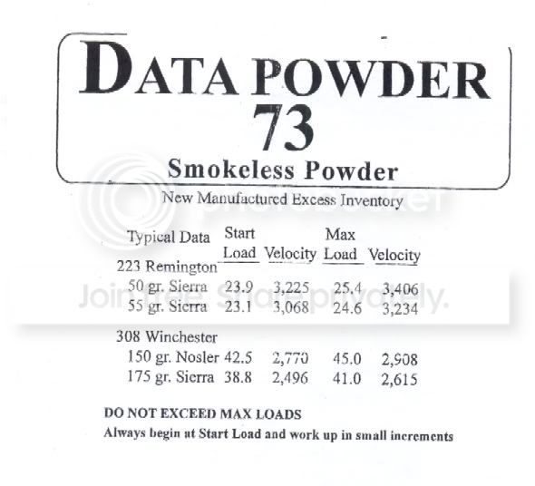

I've heard that it's more or less the same as Data 73 powder. These seem a little hot and I would use the starting loads as MAX in my view. Load with caution
It is more than a little too hot. It's "Data Powder 2200" data you want to use: http://www.accuratepowder.com/wp-content/uploads/2011/04/DP2200.pdf

I definitely concur that the Data Powder 2200 data is more appropriate for WC 735, at least with the lots I have used. 40.5 grains with Hornady 150 grain FMJs is maximum out of my .308 Husqvarna. Anything more results in a heavy bolt lift.
