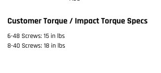

Thanks, Weaver’s website lists torque specs for the two sizes but doesn’t say what the bases come with. This is on that 9.3 so I want to make sure things are tight, when I got it the action screws weren’t what I’d call tight at all lol.Weaver 45 and 46 bases for me were always 6-48

15 inch Lbs for the torque.

I called weaver’s tech support for shíts and giggles and they’re 6-48” screws, so 15in/lbs will do me.0.138" vs 0.164" diameter if memory serves. Just measure them. And OK is correct, they make slightly over sized versions for worn receiver threads. - dan

Thee 8-40 screws require 18 inch lbs, for future reference..You didn’t tell me nothing I didn’t already know, I know Weaver uses both sizes.![]()
Weaver lists torque values for them both on their site, they just don’t tell you online which screws they come with. Nor do they list it in any of their mounting/instalation pdf’s, I’m sure they have it in the package but I don’t have that.Thee 8-40 screws require 18 inch lbs, for future reference..
