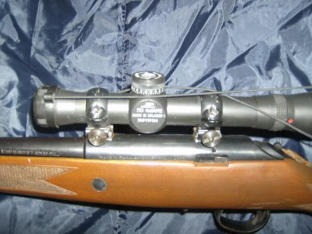

4x24 Made in Belarus mounted on a Norinco JW-103 (7.62x39)
