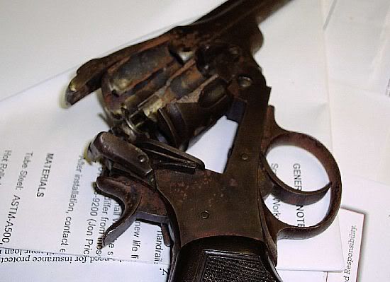

blown MKVI webley
Here is a picture from Grant R of a webley converted to 45acp.
They seem to think that this blew after shooting handloads?

To put in perspective though lots of pics of modern guns out there in the same shape. Feed a gun the wrong pill and it will hurt you.
Actually, the round which blew up this cylinder wasn't a "hot handload" - it was a factory load, headstamped "WCC 85 Match".
As a "Match" load, it would have been very precisely loaded to standard specs (or might even be a lighter load ... in any event, it definitley wouldn't be "hot" ....)
I find it impossible to believe that 1 match .45acp round would destroy a mkVI. There are thousands of these out there that regularily fire 45 colt, 45 acp and ridiculous handloads. I am sure that a few of em fired military issue
.455 with flanders clay packed in the barrel as well.
This one might have done all of the above many many times before the failure. failure can be a cumulative event as easily as it can be a single occurance event.
Fire to many hot handloads in a modern revolver and some day a light factory load will blow it up.
I also fail to see how the fact that the round was factory loaded preempts suspicion of the round being loaded to higher then normal pressures.
This one gun tells us nothing other then a 45 cal wheel gun by it's very nature has a thin cylinder wall.
This type of event immediatley begins a process of "ass covering" and little is to be learned about it's cause from the evidence "published" by those potentially liable.
The british Navy also issued many .455 revovlers cut to 45 acp and there is no tradition of fearing them. (use the ross as a benchmark)
I say keep pressures low and if you are suspicous of a gun look in the chambers and see if you can notice depressions that line up with the bolt stops. Also remove the latch screw and look for deformation. These two indicators will give you inforamtion about previously fired "hot" loads.
Holding 10 thousand PSI explosions in your hand aint ever going to be inheriently safe and anytime you pull a trigger there is risk.
wear CSA approved glasses, don't let your mates stand in harms way and inspect your arms regularily.
