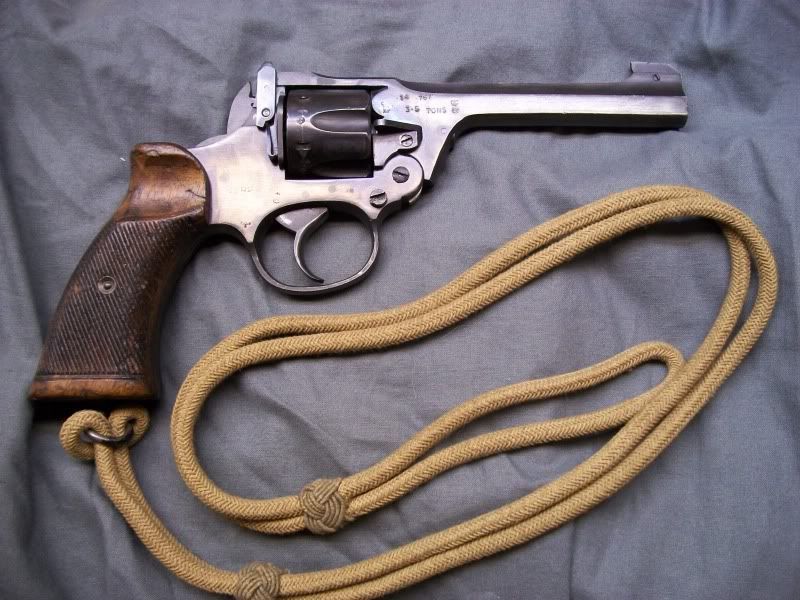

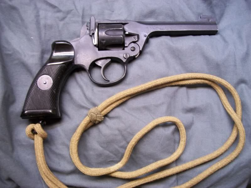

Just a personal choice, but I like the look of the Enfields.
Top is a '43 Enfield No 2 Mk I**
Bottom is a 42' Albion Motors No 2 MK I**
My advice: What ever you get, be sure it comes with the Lanyard Ring as loose ones seem to be impossible to find.
And no, I don't want to sell one. :p
