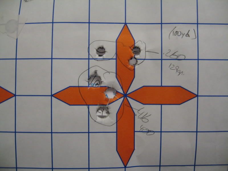

What a revelation! Had a chance to try the .416 Rigby this afternoon and it was much more civil than I had expected (just goes to show that your imagination can generally imagine worse things than reality).
After taking a few shots offhand I settled into the sandbags to zero the scope. Here's the end result (three shots at 100 yards):
The three smaller holes were made while zeroing a .260 Rem Ti (another pleasant surprise). The squares are one-inch across.
Bottom line: This was a bit above the Re22 starter load (using 400 grain Hornady SP's. Shooting while standing was definitely a bit easier, but the sandbags were used to set the zero and to see how accurate the load was.
Very interesting rifle/caliber. Recoil is more like a "heavy push" and not as "sharp" as, say, a .300 WBY ("heavier", though).
(Neo: I only shot 14 rounds. I saved you 6 for tomorrow :) )
