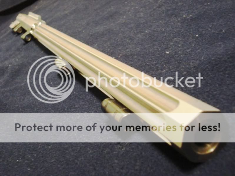

It depends on the size, depth, and length of the flutes. We did a heavy octagon muzzleloader barrel for a customer and it made a huge difference in weight, but with the octagon profile the fluting was removing more material than is would on a round barrel.

Actually, most fluting doesn't add enough surface area to make much of a difference as far as cooling goes. You'd need to make several deep and narrow grooves to get decent cooling. It can shave a lot of weight though, that octagon barrel lost just over a pound.

That octagon barrel is a seriously strange application of fluting to my mind.
Wouldn't it be more cost effective to build another gun with a slimmer barrel to start with? If there is enough metal to flute like that a person could have started out with a barrel 1/8 inch (or maybe even more) narrower and saved at least as much weight.

It was a custom barrel for a T/C Encore, the company that builds the barrels didn't have any other options on barrels that length. He brought it in and wanted it lightened since he was going to use it for hunting, obviously fluting was the only viable method. It made the barrel a LOT more manageable, but the machining time to cut flutes that deep on a 32" barrel was considerable. I think we only charged him $150 though, which isn't bad for the amount of machine time required.
