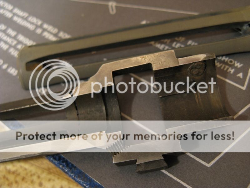

Yep, 2 welds at about 5 and 7 o'clock, just a few millimeters from the back edge. In this photo of mine, after I cut it open, you can see the rough circle on the interior caused by the spot weld.
