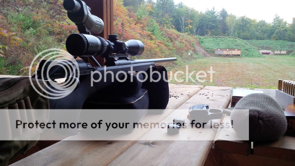

Well I am back from the range. It was pretty busy even though it was raining. So I didn't get the range time I would like to spend with this rifle to really shake it out.
[URL=http://s1340.photobucket.com/user/dbaker42/media/Mobile%20Uploads/IMG_20161002_101451_zpsrjokfieq.jpg.html][/URL]
Because of the rain I used the shoot and see targets inside of paper. I don't like the vortex scope for this weather and type of target. The reticle very much got lost in the dark target. Can be an issue also when shooting at bear during normal hunting conditions like the rain of today. An illuminated reticle would of course solve this.
As for groups, well was definitely not my best day. Here is my zero Tgt;
[URL=http://s1340.photobucket.com/user/dbaker42/media/Mobile%20Uploads/IMG_20161002_112638_zps34doqcka.jpg.html][/URL]
Because of the amount of people I found myself rushing, and not leaving enough time between groups. There was a lot of barrel shimmer that I just found myself shooting through to get rounds down, instead of being that guy holding everyone up.
Anyways, Trigger is great. Very light and crisp, very much like how I set my Timney's. I ended up adding a butt stock pouch/cheek pad. I like them on my hunting rifles to hold odds/ends and it suits it quite well.
First thing is of course, no bi-pod mount. There are company's that make mounts, or there is a spot in the stock that you can drill and add a swivel to add a Harris. The Vektor mount is what I am looking at, as I am very much a fan of Parker Hale style bi-pods. I'll have to see if there is anyone in Canada who deals in them.
I tried the remove and install barrel and well it was within what I am expecting given conditions.
Left hand before, right after;
[URL=http://s1340.photobucket.com/user/dbaker42/media/Mobile%20Uploads/IMG_20161002_112659_zpspxaqzvsy.jpg.html][/URL]
It did show better performance with the Fusions. I really need to get projectiles to better hash it out. I am thinking 150g AB's as I have great luck with the Nosler projectile in most other hunting applications I have used it in.
The action is slick, I found myself cycling the rifle faster and faster. I will try some quick aim shooting when I found a load for it.
I am pretty happy over all, even with only 30rnds down range. Hopefully will get out next weekend with it to check zero then maybe a bear hunt!
