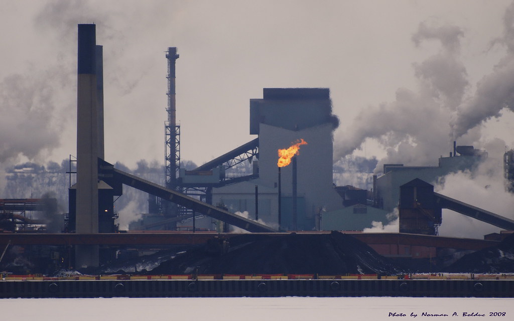

All good. I live close to two steel mills plus other ghastly industries. My fumes should be the least of the local inhabitants concerns.
