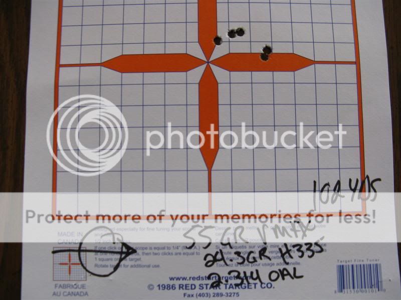

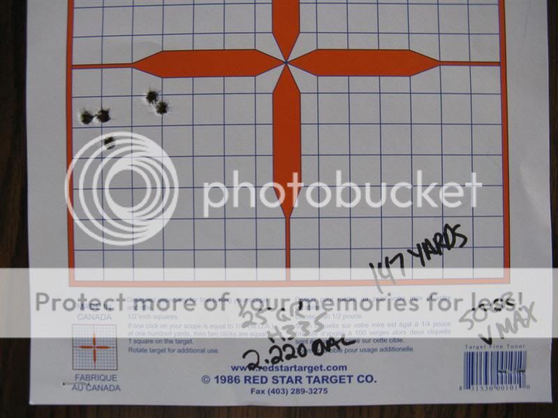

These are two separate 5 shot groups with the same ammo. I decided to try max book loads to see what this rifle liked and I will definitely be going down a grain or more and starting to move up from there in .2gr increments. I don't understand the vertical stringing.

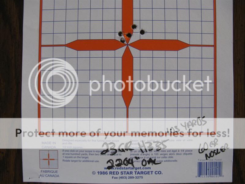

This group was last night at a longer distance with less powder and a different OAL. The rifle has less than 50 rounds through it so far.

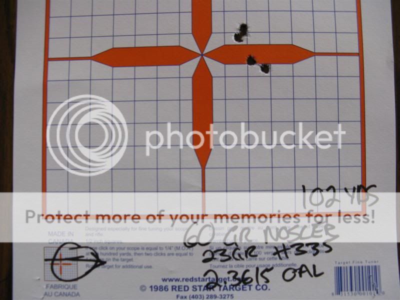

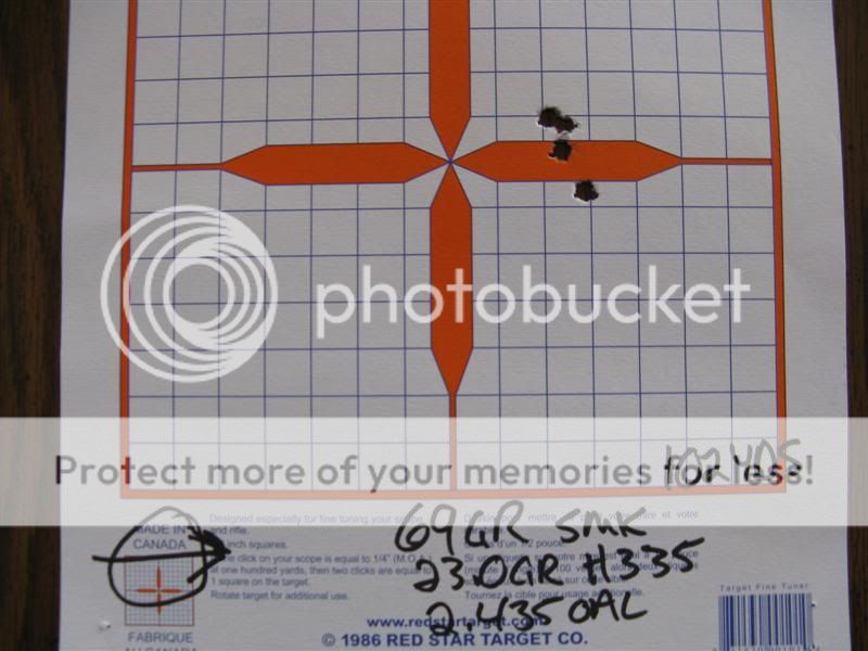

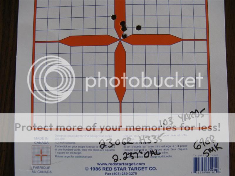

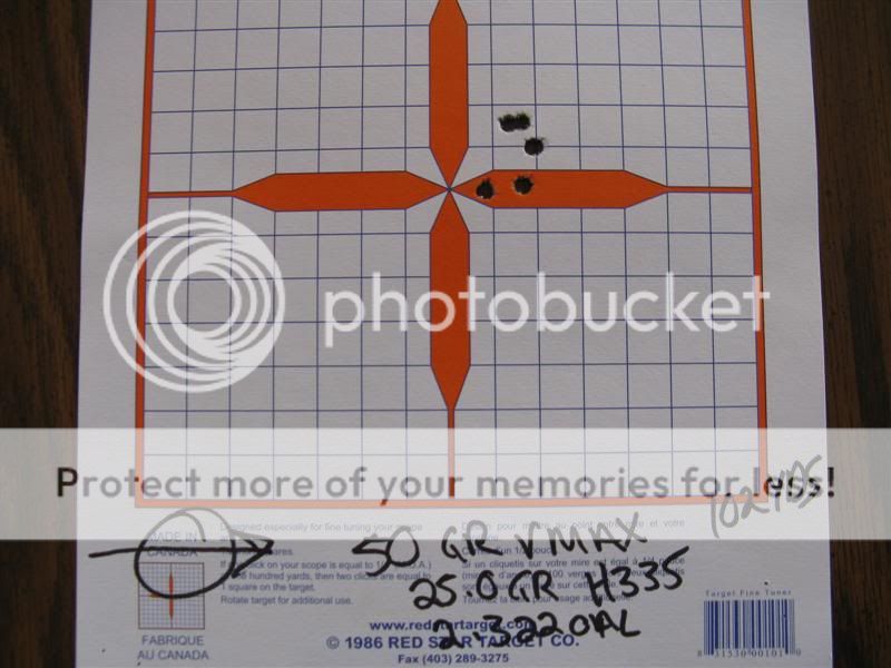

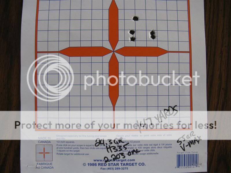

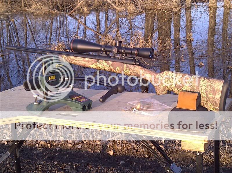

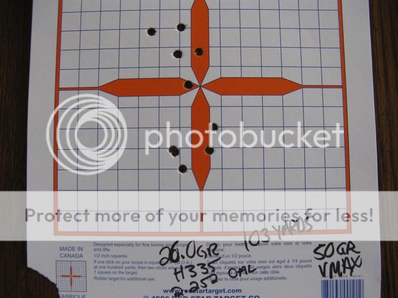

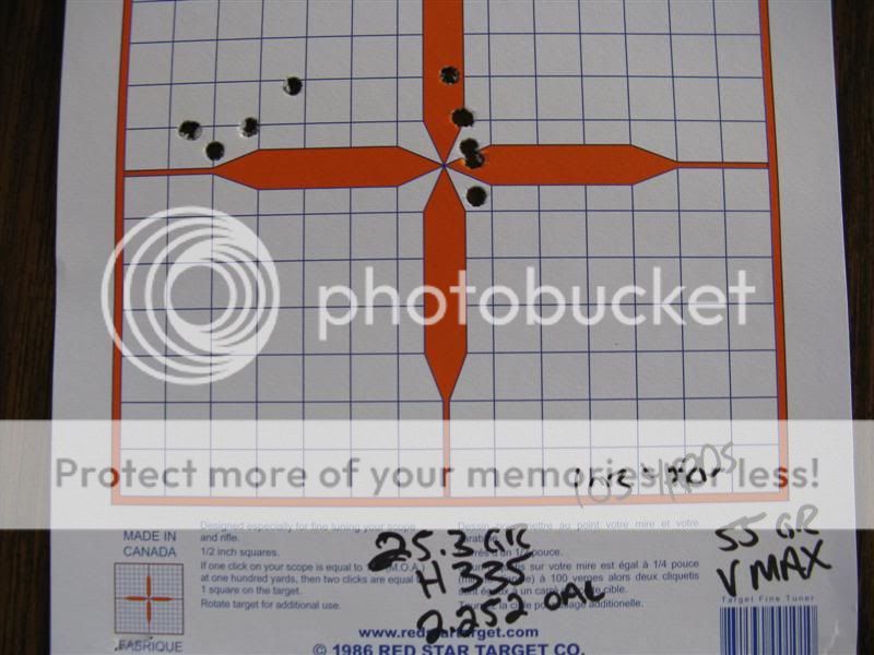

Well I went out again and somewhat redeemed myself. I made dummy rounds for each bullet and went 10 thousands less when I seated them. I used the same powder charge as the original post to see if there was a difference. I cleaned the heck out of the barrel last night and shot some foulers before I started on the 50gr V-Max and ended up finishing with the 69gr SMK. The wind was left to right about 5-10mph when I started and strong enough to move trees with no leaves when I was done. Probably too strong for a kid to fly a kite. I probably only shot 200 rounds last year and I realized today that I need a lot more trigger time. I definitely need to work on my consistency and technique. The rifle is a Savage Model 10 Predator Max 1 (Accustock) and I haven't done a thing to it. 22" barrel and 1-9 twist. Here's a cell phone pic of the rifle and my ghetto table.
I think these pics are self explanatory. 5 rounds each and I didn't take my time between shots. I would let the barrel cool between the different loads I tried though.
