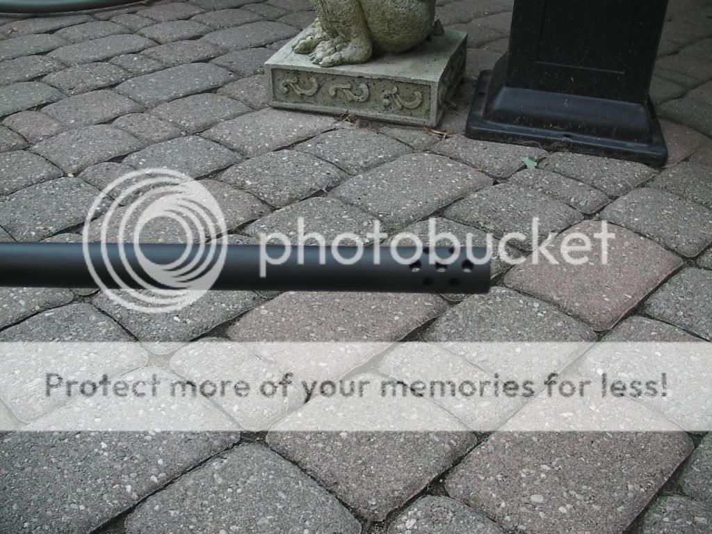

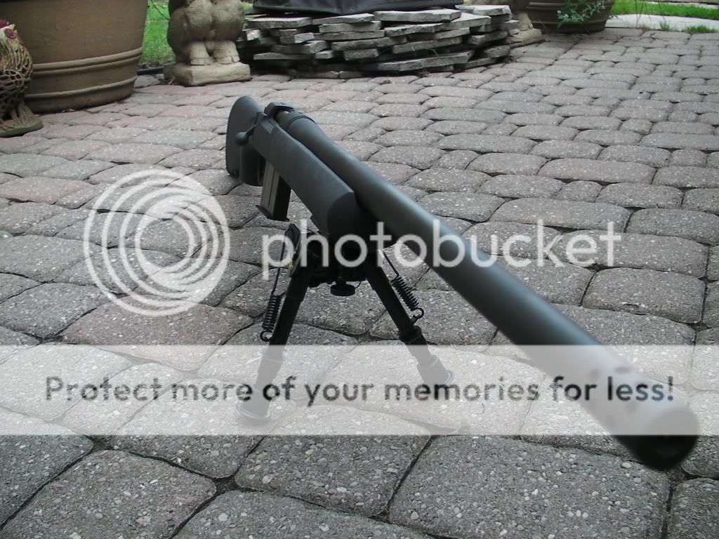

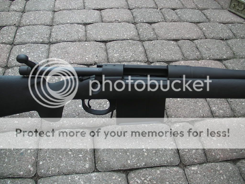

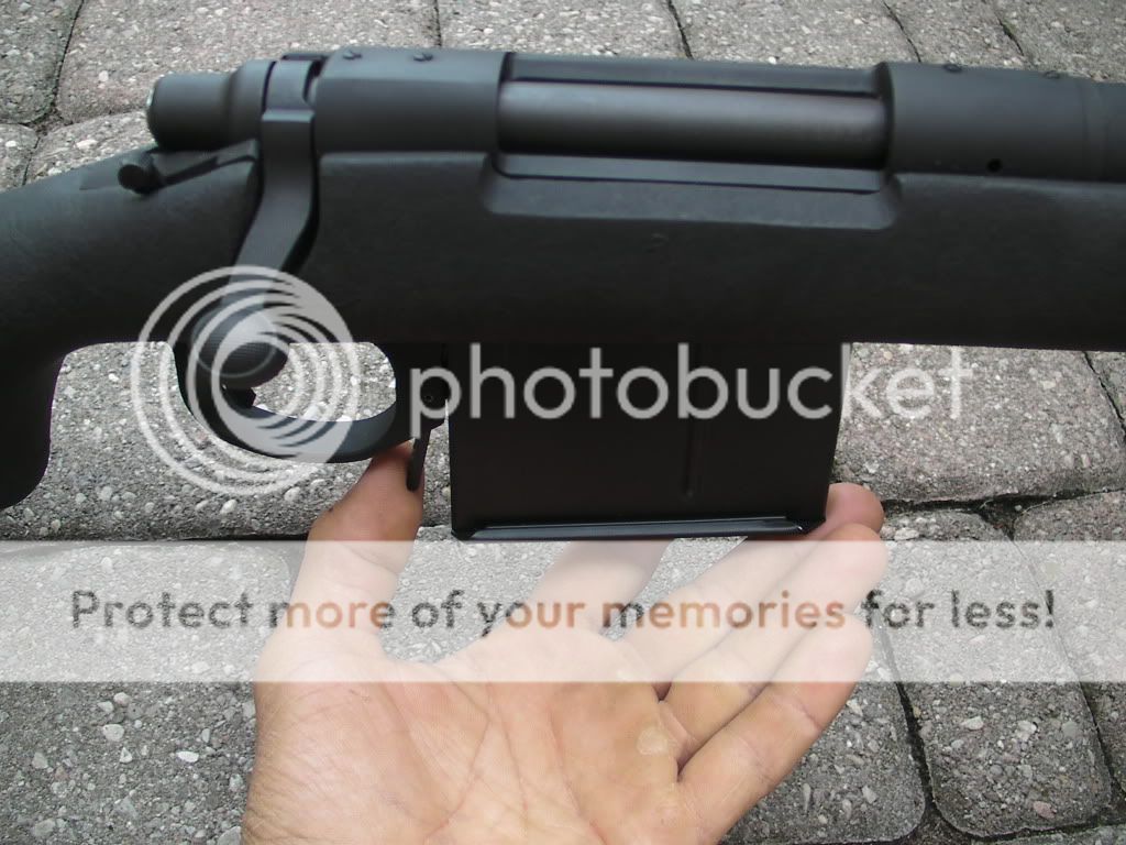

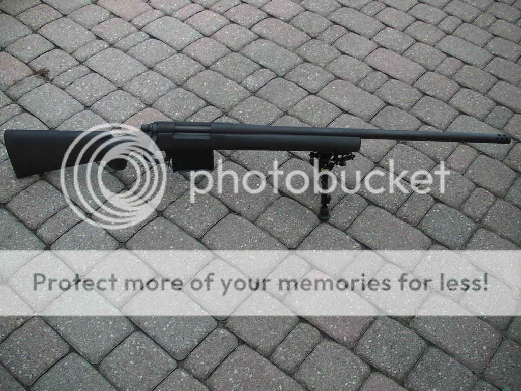

Well, I finally have a bit of time back on my hands, so my .338 build is finally getting taken off the back burner.
I have a Remington 700 Police chambered in .338 Lapua Magnum, and I have a Sightron SIII Fixed 20X42mm with a 30mm tube.
What base and rings would you reccomend for a rifle such as this?
Main shooting distance will be from 100-300 meters,
I plan to put a lot of rounds through this rifle, so the parts have to be very durable.
The threads for the base are #8 thread, so that probably narrows the search down some as well.
Thanks for your input.
