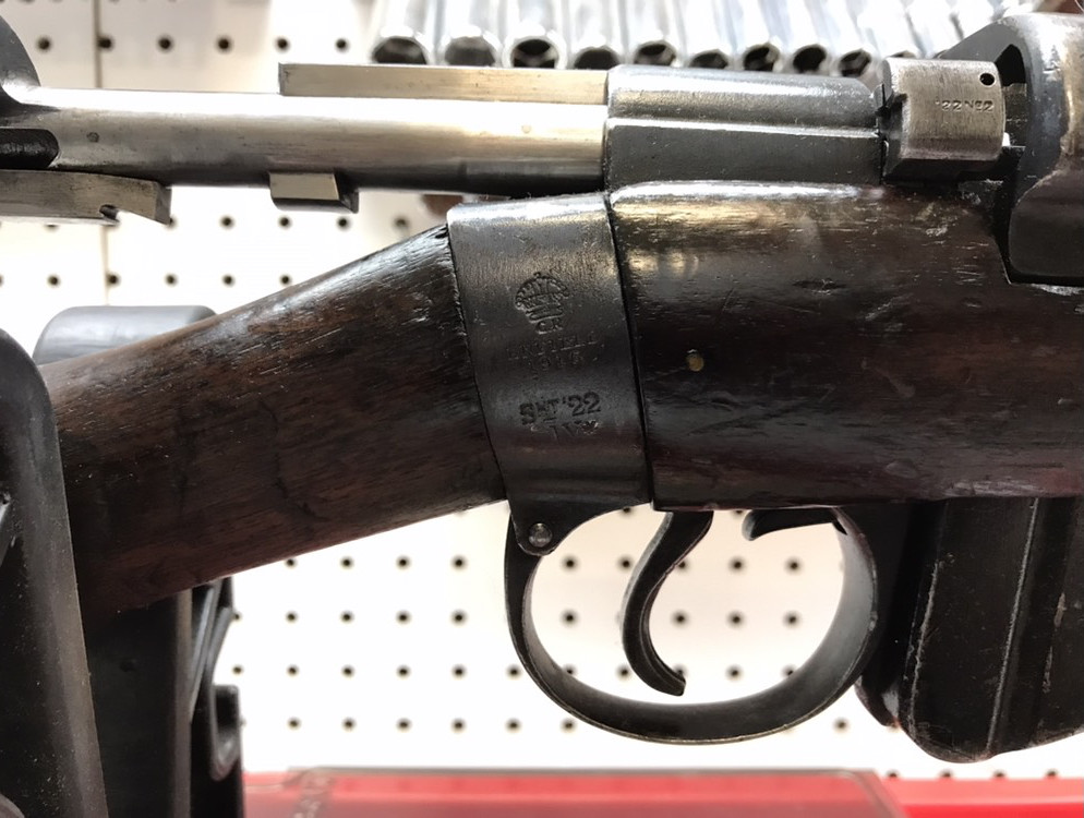

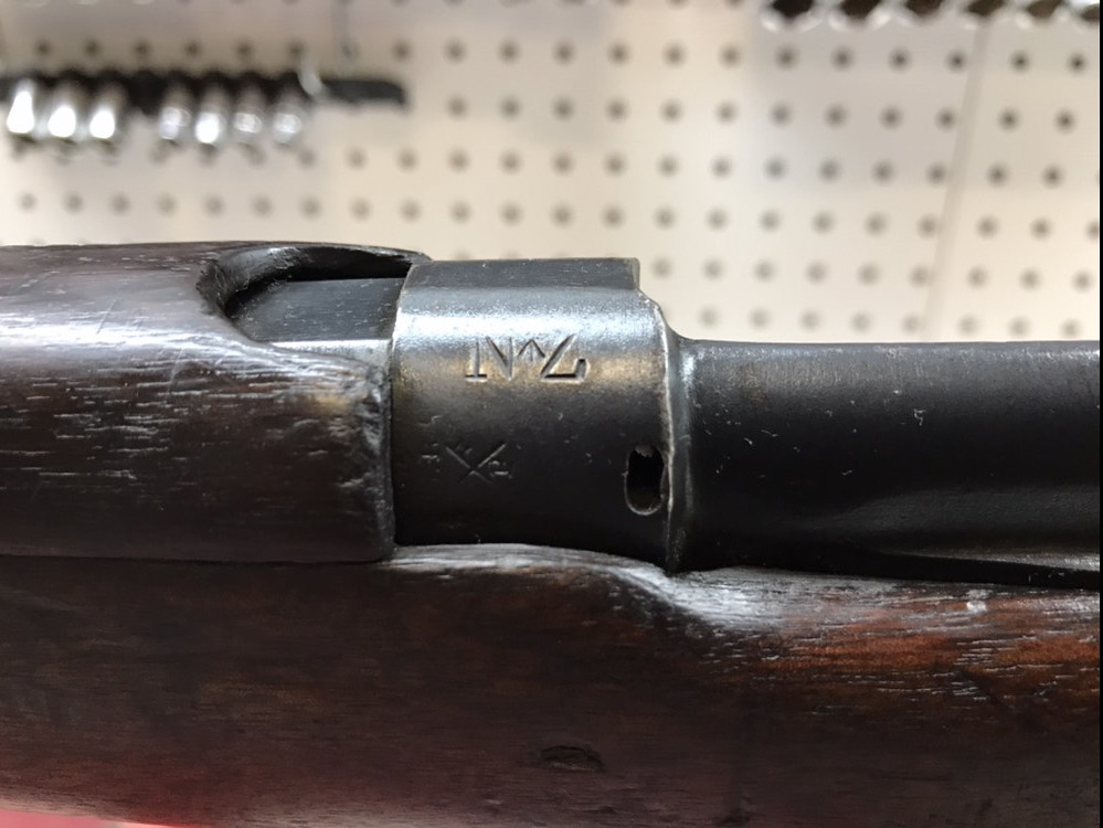

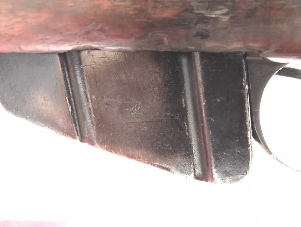

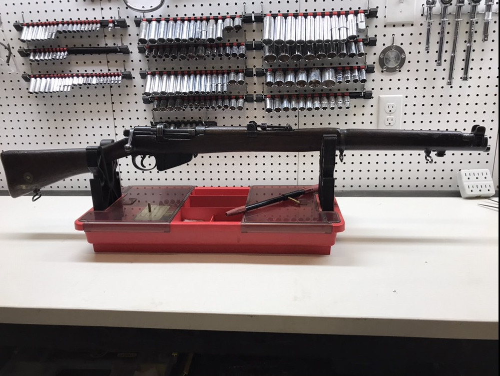

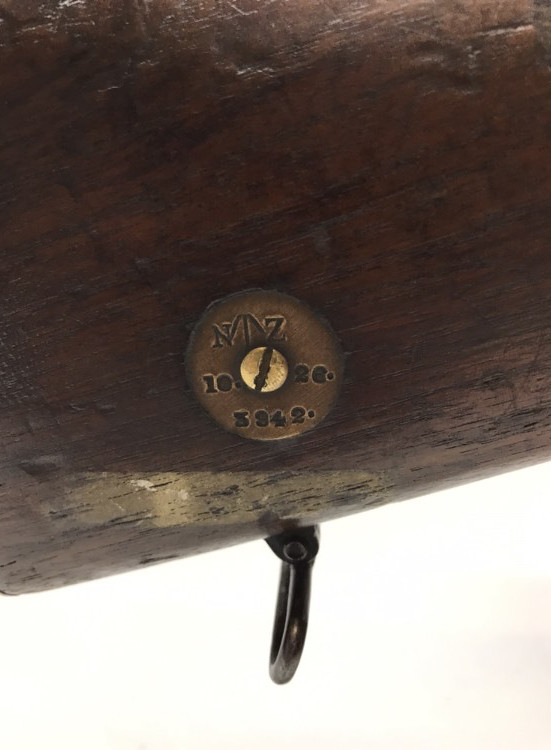

Hi Sonny. This is a nice untouched example of one of the .22 cal SMLE conversions Nicely marked. Nicely dated. Appears to have the original 1916 walnut stock and blued metal. Magazine nicely marked and original to the early .22s. If you gently pop off the rear hand
guard more than likely you will see a barrel date which appears on the left side of the knox form (top flat on breach area). It will look
like '28 for 1928 for example. That is one indicator of the date of conversion. If you get really lucky on the left side of the body socket
will be a '28 in similar fashion to indicate a date that it went into the arsenal for repair or conversion. Often multiple dates appear. Be
aware that these rifles were simply used to near death by many services including Cadet Corps and often with bad ammo so the chance of getting fab shooting out of it doesn't make sense. But it is exactly as collectors want - original and untouched. Please maintain that philosophy. JOHN T.
