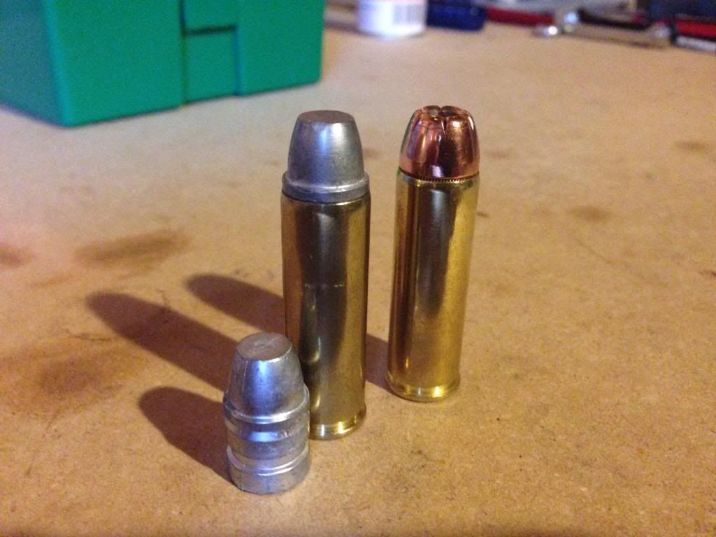

This is the crimp I use on my 500 S&W rounds. Not enough to buckle the case, but enough to keep everything in place. They feed well into the cylinder too. I'm using N110 charges in these with either large pistol magnum or large rifle magnum primers (depending on the brass).
Just wondering, but in Canada, what's the point of having bullets like the one on the right for that round? Since it can't be carried in the bush for protection (stupid laws, stupid government interference, blah blah blah), I just don't understand why it would be used. Totally not knocking you, I'm sure there's some kind of reasoning, I'm just wondering what it is...thanks
Just about any factory ammo I've seen for sale locally it's all hunting or self defense ammo for the 500 mag. Any jacketed bullets for the 500 for reloading are either soft point or hp. I don't think I've seen a fmj for the 500 for reloading.
Also there is the handi rifle chambered in 500 mag which I assume can be used for hunting (legally speaking I mean).
So then I guess the question begs, what is the point in even owning one of those handguns, other than the "it's cool" factor? Expensive as hell ammo I'm sure, boat loads of recoil, and for what though, when it can never, ever be taken out hunting or even as a bear/beast defense cannon? Not trying to knock the guys that have then, I guess I just struggle to see why. At least the "more regular" handgun cartridges you can shoot all day for relatively cheap and still have fun and go home and use your hands on your woman (or yourself if you're lonely) but with the hand cannons you take out a bank loan, go shoot for a day, then you and your missus go to bed and just sleep.....
There is absolutely no practical reason for me to own my Smith and Wesson 500 in Canada. There is also no practical reason for me to have a jacketed round for it. But guess what... I have both, and I'm happy... :D
If I really wanted to, I can hunt with it. Just not in Canada. Ammo is cheap if you cast your own bullets, which I do. This gun is actually the reason I cast my own bullets and got into reloading. I've shot it a lot and never put a single round of factory ammo through it. My most expensive ammo is the jacketed rounds where the bullets were about $1 each. The cartridges use the same primer and less powder as 308 Win.
cheier pretty much summed it up, i reload for everything i own and cast for most of it including the 500. i get a kick out of the recoil and love watching people shoot it who never have. with my cheapest lead it's about 30-35 cents a shot for me vs the factory stuff at $3.50+ per round.
this isn't to be rude but going by your logic, why should i even bother with guns in general with all the red tape involved, it would save me lots of money and no lead exposure. i do what i do because i can and want to. that's the only reason needed, very simple.
OP, Its a matter of want, not need. We buy them 'cuz we want them. Yes they can only be used for target purposes in Canada but there is a huge difference in handgun types, which most people never get to experience. Why did u buy a computer? Its more of a 'want' than a need..You can get by without one, although it is getting more difficult to do without as time passes, but many folks do not have one. We dont always make practical purchases but we buy what we want. I am sure you have done the same.
Fair enough, to both answers! I really hope that my question wasn't taken as rude, I guess i just was curious what the motivation is. But the answer is fair, and I guess until I get an RPAL it might not be something I fully grasp yet! But i can understand owning something just because I can, or because it's a hell of a lot of fun!
On top of that, if it's as cheap as you're saying when casting/handloading, then absolutely why not.... no more expensive than reloading for and shooting a rifle, probably cheaper since you're casting your own bullets...
