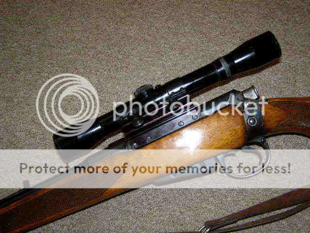

Winnipeg Toymaker, you have peaked my interest with your comments on the scope and mount. I have been looking for a similar scope mounting system to match up with the hole pattern drilled on my Long Lee Enfield. Looks very much the same as the one that you identified in the picture.
Here is a pic of another rifle with a mount that I found on the net. Anybody recognise it? Is it the same Cooey unit? Huh? Huh?

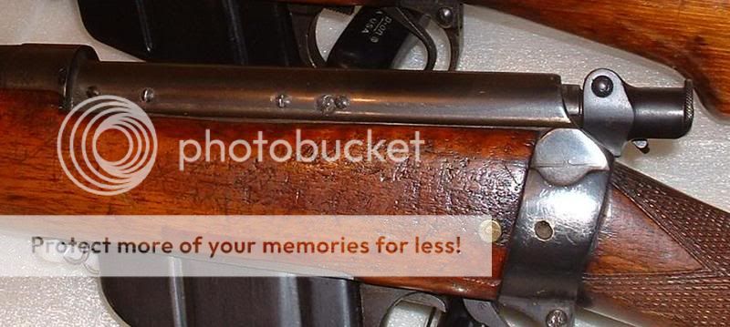

Here is the hole pattern in my Long Lee.
The one on your rifle has a rounded base ( fits the contour of the action)and is one piece unit c/w rings and fits only 3/4 inch scopes. The later picture shows the replacement ( newer) side mount for the Cooey that fits 1" scopes. This is noteable by the large headed set screws that hold on the second part of the mount. This second part can be got in high or low rings. The action has to be drilled and tapped to accept the mounts. The long Lee I had was not tapped such so someone did the deed. As you may be able to tell , the last (RH) hole was drilled too close to an original screw in the last pic. And the scope was an early (60s) scope.

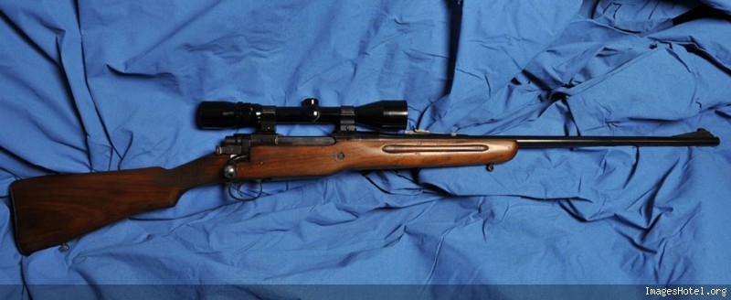

Chemist,
From the checkering pattern and stock cutting, your rifle seems to be what was called a B.S.A. model B, marketed by Parker-Hale, or a copy of it, anyways. They usually show a groove in the foreend though, but some did not have it.
The rear sight protective "hears" were milled down, drilled and tapped for both scope mount and receiver sight, the barrel was shortened to 24" and had a ramped front sight.
The receivers were re-heat treated and usually look "purpleish"... also made with M-17 in 30-06 and .270 Win.

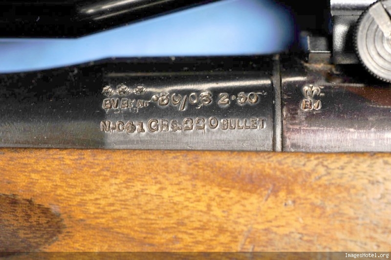

Below is a 30-06 (M-17 based) BSA rifle, and the markings you should find on.
There were other variants, this one being the "economy" one. Others have re-worked bolt handles, re-worked magazines (reshaping) etc.
You also can see the "purple" of the receiver.
nothing irritates me more than a long lee that has had the classic dust cover ditched in order to drill and tap the receiver. That has to be on the top 10 list of milsurp sins.
