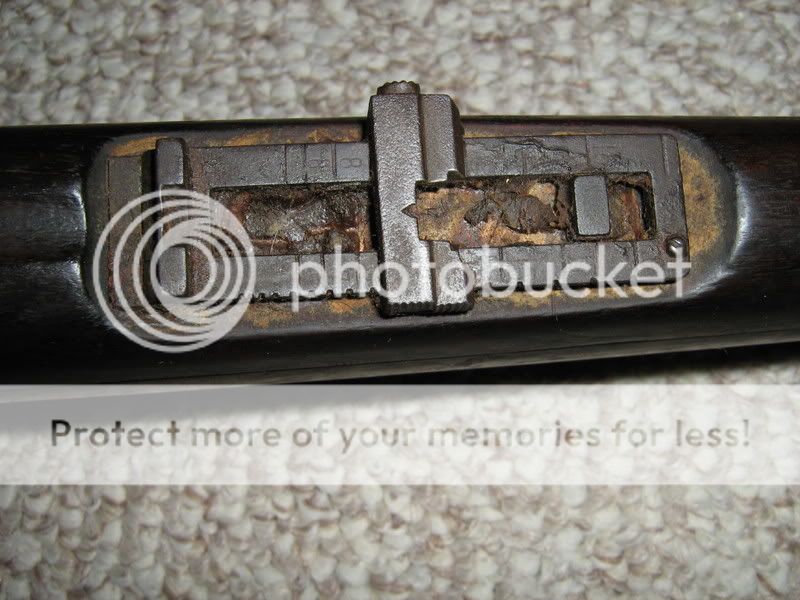

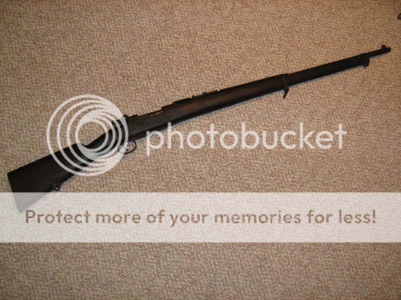

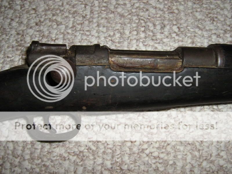

Your rifle is a family heirloom. Not necessarily in the same category as a spinning wheel, an embroidered sampler or great grandma's three-handled family credenza. Treat it with respect.
As Riflechair suggests, give it a good cleaning. I prefer very very hot water and a stiff scrub brush, before resorting to chemicals. In that instance I use citrus engine degreaser and more hot water. And never use sandpaper on the metal! There is a patina under there that tells a story.
There are electrolysis cleaners that use positive and negative charges to remove heavy crud from barrels. Give yourself some google time to learn more.
The bore is going to be a disappointment if the outside is indicative of the quality of care. Don't try shooting the rifle until you know for certain what the chamber shape is and what the bore diameter is. I suspect the muzzle is badly worn from ignorant cleaning rod flailing, not a sign of its larger diameter.
