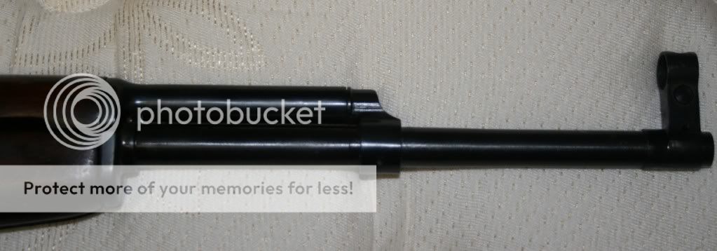

what do you guys think of this?

wanted to lighten up a sks for a young lady shooter, and this is what i ended up with. bbl is down to 18.5 , and as you can see, nothing left underneath. the holo sight is holding good. just kinda thought it turned out neat, and thought id see what everyone thought.
i think if she likes it, and all that, the next thing im gona do, is swap out the bottom of the mag housing for a flat 5 round one off a chinese one, if it can be found. if not, ill mill it down myself.

i built that one. its the factory cover, i just got the right shape of weaver base to fit the cover, ( it was for a marlin of some sorts, and i have the number writen down in the shop) and drilled/ tapped the original topcover. it holds very well, its so dam tight to get the cover back on. it will prolly lossen up after some shooting, but it will be good enough for plinking. i made sure the hOLO is back far enough to be able to use the stripper guide still aswell.
dont really know how much i took off, guess i could weigh up the leftovers. it definatly feels different

actually, beleve it or not, the holo is very comphy. its a very good fit for me. feels quiet natural.
it hasnt changed how it shoots at all , by removeing that 1.5" of bbl.
its become sombodys fav guy allready. now, if someone has any idea, where i could pick up a flat 5 round floorplate, that would get done. ive struckout wherever i have asked
did you do the barrel chop work yourself? I'm kind of thinking about doing the same to my Ruskie. Details of the work, including were it was done and what it cost you (if you had a gun smith do that is) would be great.

Quick question - how did you shorten the bbl 1.5" without flaking the chrome lining in the bore and ruining the crown?
Also, I think you might want to consider one of the short rails that replaces the rear sight and going with an Aimpoint Micro or similar sight.
Considering the look you're going for, you might also want to consider a ruggedized stock like maybe a chinese red fiberglass or something?
