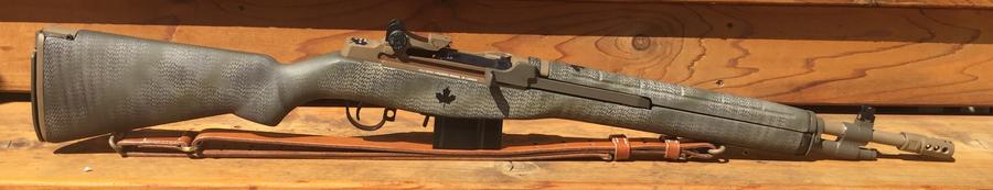

The rifle would likely look pretty close to this, but with Cerakote (this is a LB build I put together the pics were posted in the IDF pics thread).

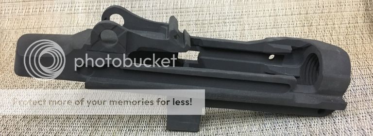

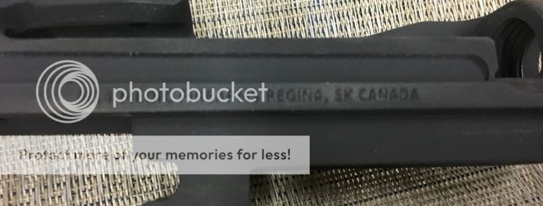

Here are a couple pics of the receivers I have already had done. I guess the big question is whether I send out anymore for custom work....

Gotta love that ###y looking M14Medic Regina, SK marked receiver! ha ha ha :cool:
It's a thing of beauty!
And like I've reinforced at the clinics, "It's a Norinco; you can only make them better..." :p
Keep up the gorgeous work! :wave:

Here is the last one I finished up, it’s a display model, I believe you know the fella who did the Cera-kote!

damn that's a fine looking rifle right there.

I guess I could send one of my '05 receivers out to Nick ..... I'm assuming that's who did the receiver refinish/engraving?
