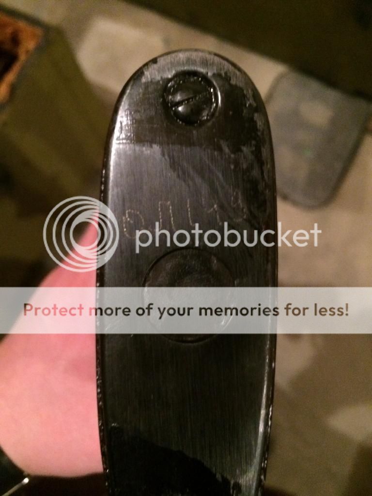

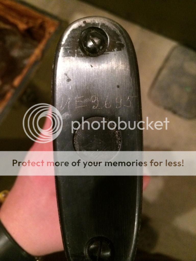

Truly "all matching" rifles are hard to find. Generally to be all matching they need to be found as un-issued. Even the butt-plate should have an electro-pencil serial number and the gas system. This electro-penciling is original. There are many matching rifles, but the butt plates have been refinished (light re-furb) or the stamped parts are all matching but the metal has been refinished so the electro-penciling on the gas system is missing. All the parts on the above two variations are probably original to the rifle, just they went through a refurb (light to moderate) so they are missing some truly "all matching" serial numbered parts. Sometimes the butt plates were re-finished simply due to some minimal wear on the butt plate in an arsenal rack, so the minimal refurb may just be some dabs of paint on the butt plate.

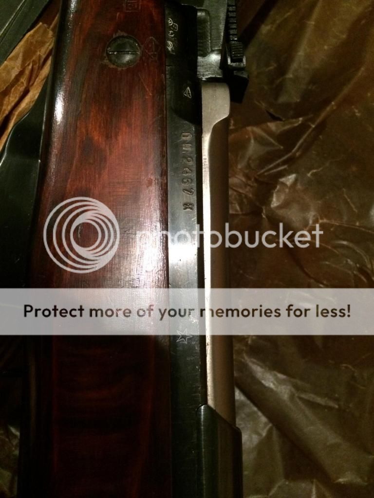

The other place people don't check is the bolt/breech block, when you take it apart, many rifles have mm firing pins etc, but because the cocking handle is matched to the rest of the rifle many people never check the smaller components to see if they are matching.

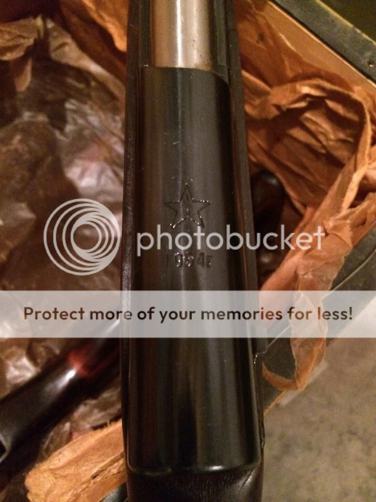

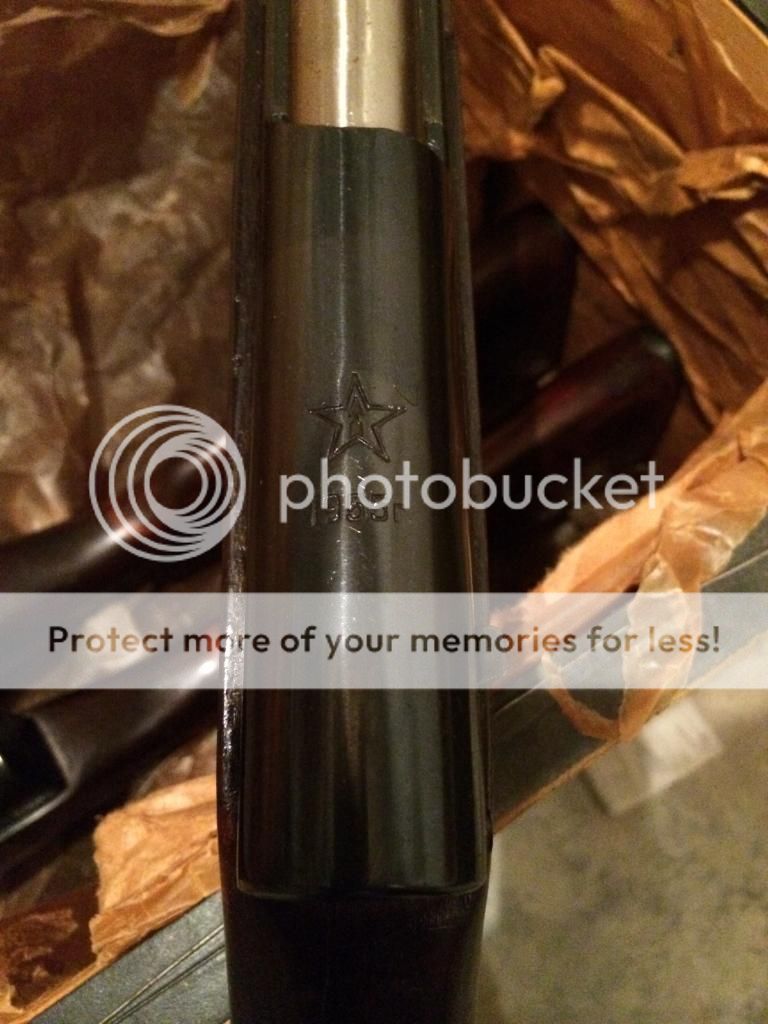

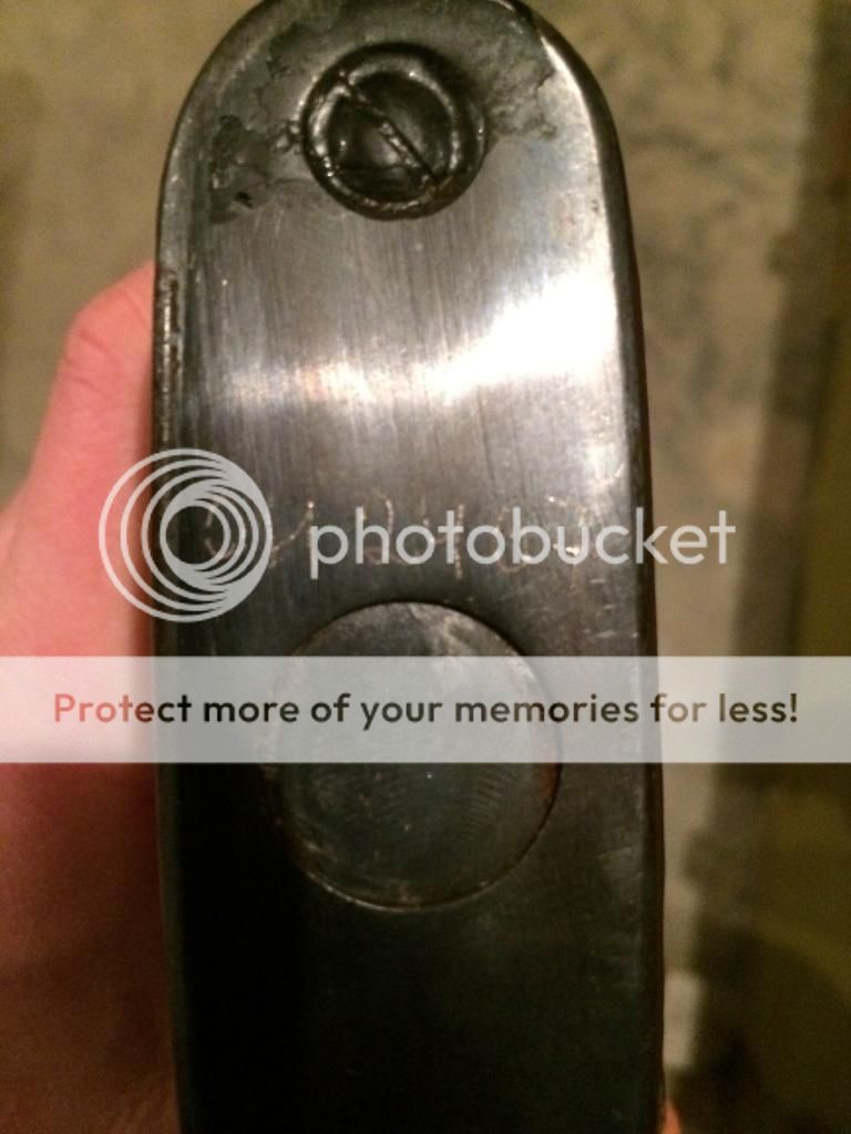

Okay, after taking my collection out of the crate and examining rifles built from 1949-1955/56 with 1953 & 1954 Izzy SKS's examples as well. All rifles are un-refurb'd except for for my 2x 1949 rifles and 1x 1953 Izzy. Despite being unrefurb'd, some rifles have small paint dabs on high point wear on butt plates due to storage wear. It appears as if Tula started serial numbering their butt plates with electro penciling in 1954 and that this was not an anomaly. The only rifles I have 1954-Post that don't have electro penciling on the butt plate were minor refurbs where the whole rifle and wood matches but they decided to paint or re-finished the entire butt-plate (Still all matching rifles, but these examples without the electropenciling went through a greater refurb process and are 'less' original as they are technically not all number matching for those years/make).
