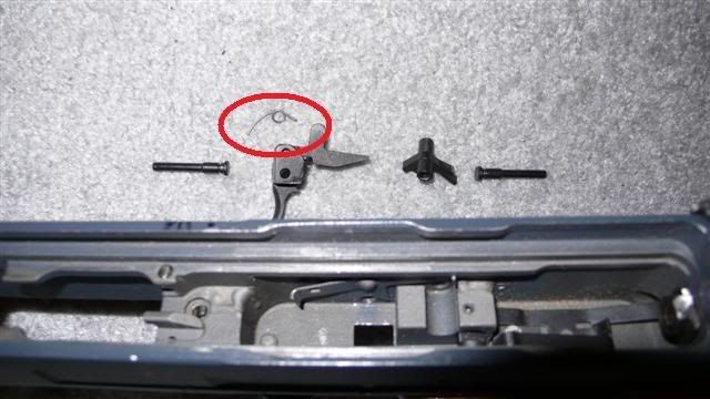

What does this cz58 spring do?
suprathepeg
EE Expired
117   0   0
Mine fell out and I don't know where it goes.
rifle has functioned flawlessly without it though.
It sits on a trigger pin to increase the tension , absent on the milspec one and some other versions of this rifle.
Mine landed in the garbage long time ago but it's up to you what you are going to do with it. There is a scratched area at the bottom of your receiver just in front of the trigger hole , that's where the longer end of this spring sits.
