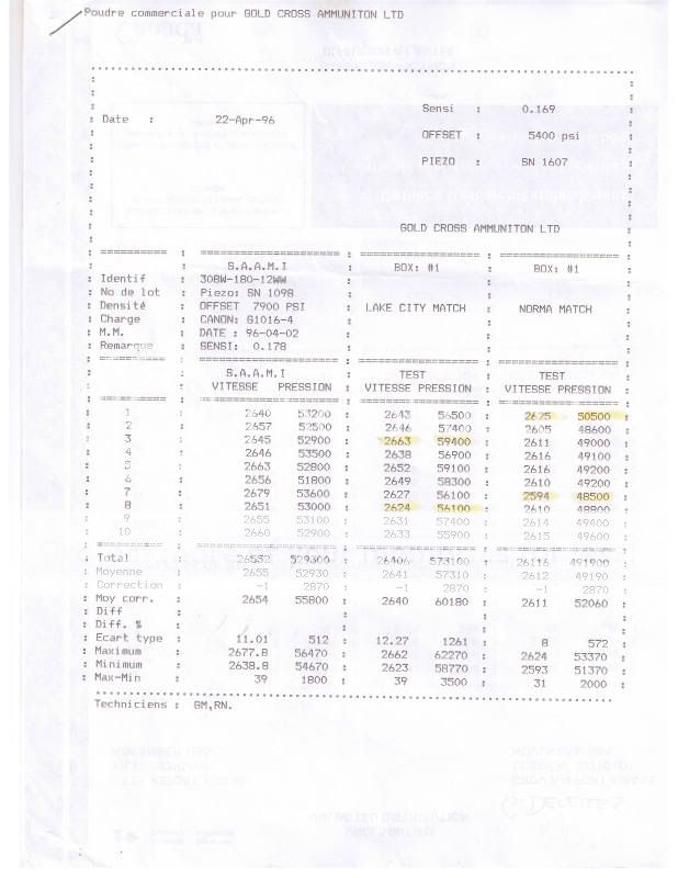

Here is what a raw pressure test looks like. The reference 308 ammo in this case was made by Winchester. The pressure lab was at Expro, Valleyfield, PQ, the maker of IMR brand powders. This test would have been 4 to 8 pages of tests, all in 308, and starting with reference ammo. The ammo submitted included some quality ammo that we had on hand (Norma Match and Lake City Match) that we wanted tested so we could use it as our own "in house" reference ammo in our pressure gun. As you can see, the Lake City was about 57,000 psi and this was the pressure range we did not want to exceed in our ammo.
By the way, Lake City is quality USGI ammo, and you can see why I have often posted that the pressure limit of NATO 7.62 ammo is about the same as 308 Win. The limit of 50,000 for NATO is CUP, not psi. The psi limit for both 308 and 7.62 is over 60,000 psi.
