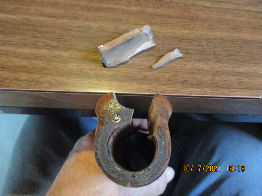

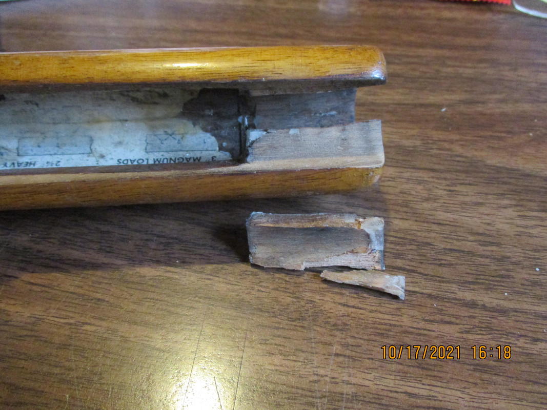

What is the best glue to fix my cracked forestock. 2 part epoxy didn't work. Any ideas? I can get the 2 part epoxy off with heat and a wire wheel back down to bare wood. Browning auto 5 magnum part number P011170. I would love a composite stock.
I am not an expert wood repair guy, but I think you get one chance to glue a repair correctly - you have used up that one chance. The remnants of the glue / epoxy that you used are now going to hold the wood pieces apart for whatever you do next - so magnifier glasses - tiny scrapers - have to peel that off without removing wood fibres. For a similar attempt, I used "Hot Stuff" from Lee Valley - like water - very "thin" stuff - to trickle into very tiny cracks. It is a cyonacrylate glue - so like crazy glue - sticks and holds like crazy when it sets- but so far as I know you get one chance at it - no readjusting, etc. You probably need something that has next to "zero" thickness to hold tightly - other wise you get a glue line when you are done - I have many "glue lines" showing here - is actually hard to get the correct glue, clamped tight, etc. Guys who can glue wood pieces without glue lines amaze me!!!

Looking at the construction of the stock I think this ^^^ sounds on the money. I think I can see another crack forming at the bottom of the stock.
If I were you, I would go for the composite stock you want - if you ~~really~~ want to try to save this one, cut the broken bit out and graft a new piece on using a quality PVA glue. Then cut/file/shape to fit.
I agree with sean69. You will not be able to remove all of the epoxy without removing some wood, which will result in the original pieces no longer fitting. No adhesive will make a good bond over epoxy. PVA has a shear strength of approximately 3000 PSI on a well-fitted joint and I would consider it to be the best choice.

For OP I'd contact someone that does 'real furniture' repairs, they may have a solution but it may be cheaper to replace the stock. One chance may be putting some dowels or pin in there or a biscuit?

It is interesting that the OP's broken piece is from the front of the forend where the magazine cap screws on. These guns are notorious for splitting the rear of the forend (i just finished repairing the forend of my Dad's Remington Model 11 which is an Auto-5 clone) but I think it is unusual for the front to split.
