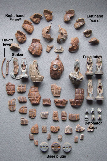

I hope the owner of the pics is okay with me using them here. I have presented them for the education of Canadian gunnutz. Cheers :D
Testing that was conducted proved that external serrations had very little impact on fragmentation, as evidenced by this pic. The only advantage to external serrations/segmenting was that it provided a better grip with cold/muddy hands.
Internal segmentation was much more effective, however this was a greater manufacturing expense and complication, thus not popular for an item meant to be churned out in the millions.
This lead to the post war practice of pre-fragmentation, such as notched wire like the M61/M67 or fragments/pellets embedded in a casing medium.

From what I've read, one of the big reasons for such uneven fragmentation on the Mills Bomb is the offset fuze. Because the detonation is centered on one side you get inconsistent fragmentation.
