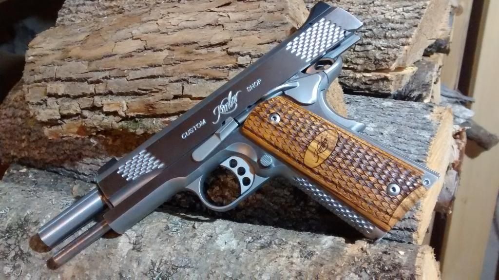

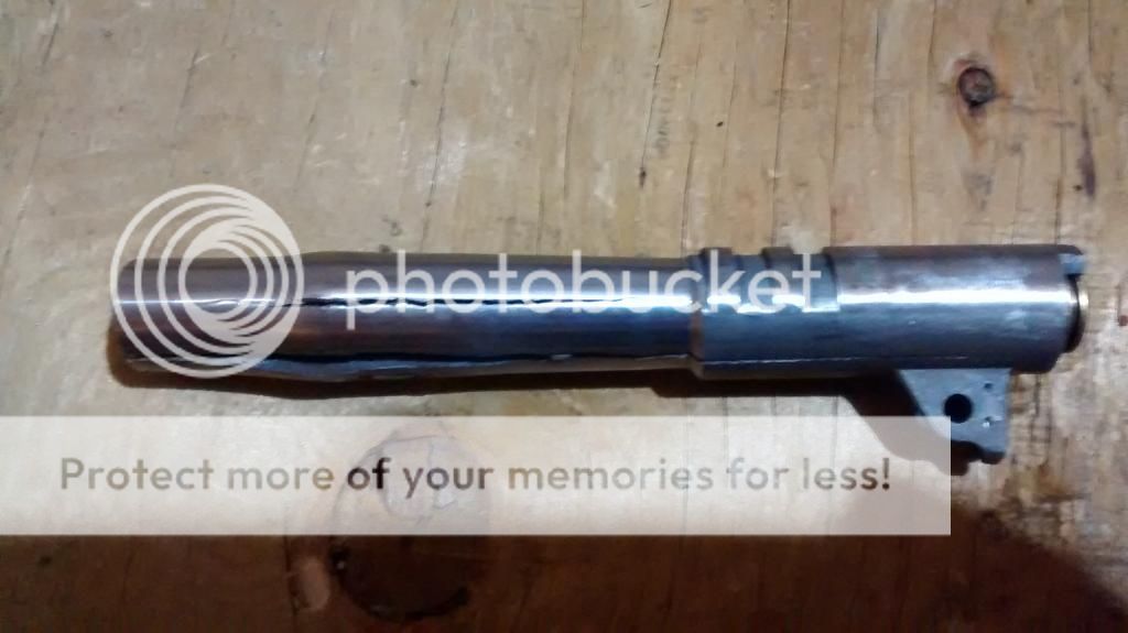

Previous owner got a 10mm mixed in with his .45's 10mm case didn't eject and was pushed into the bore and when the .45 behind it went off it blew the barrel, luckily no one was hurt, and surprisingly the only things on the gun that had to be replaced was the barrel and bushing. the gun was locked up solid and took some real work to get apart but hard work and big hammers prevailed
here it is put back together
