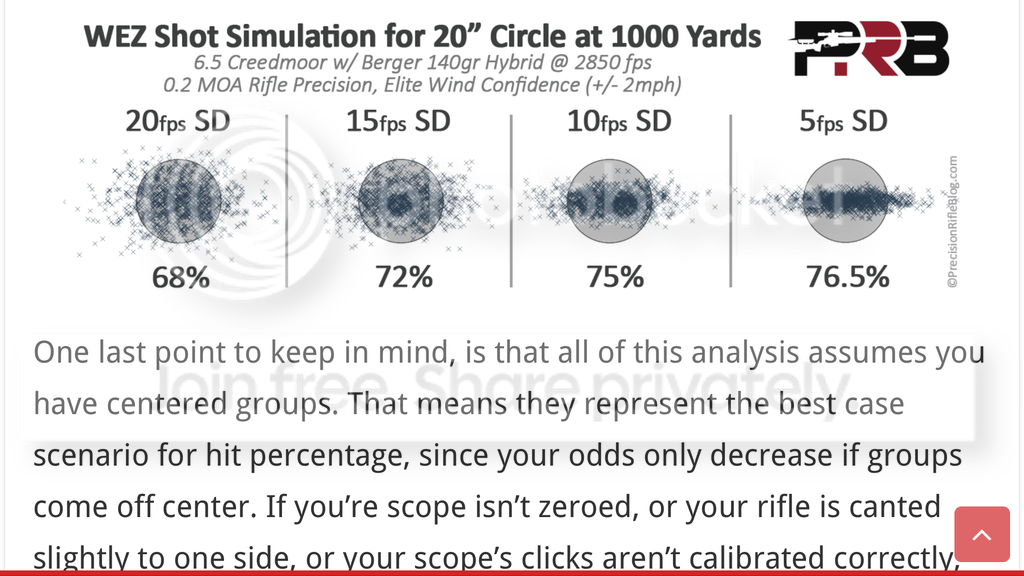

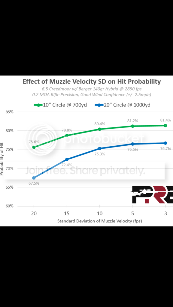

Well to me a low standard deviation tells me how consistent my hand loads are . A low standard deviation will give me a better probability of hit percentage then a high one . there are many factors in long range shooting not just how accurate you can aim .to me it's a goal ,I'd rather have my 7.9 fps then 30fps any day
Look at the difference between 10fps and let's say 20-30fps . I believe it not only affects at long range but imagine at 100 yards you have a Bullet that comes out your muzzle 30fps faster then the previous 4 , well I think the point of impact on that bullet will be different then the other 4 even at 100 yards . Then multiply that by 10 for a 1000 yards , it could mean the difference between a kill or a miss , so yes I do believe it should be another of many goals .
....so yes I do believe it should be another of many goals .

The lower your SD is the more accurate your average muzzle velocity will be for your ballistics program the higher your SD is the more inaccurate your average muzzle velocity will be for your ballistic program . Am I right or wrong , if I'm wrong what method should a person use to determine the best muzzle velocity number for the ballistic program?
