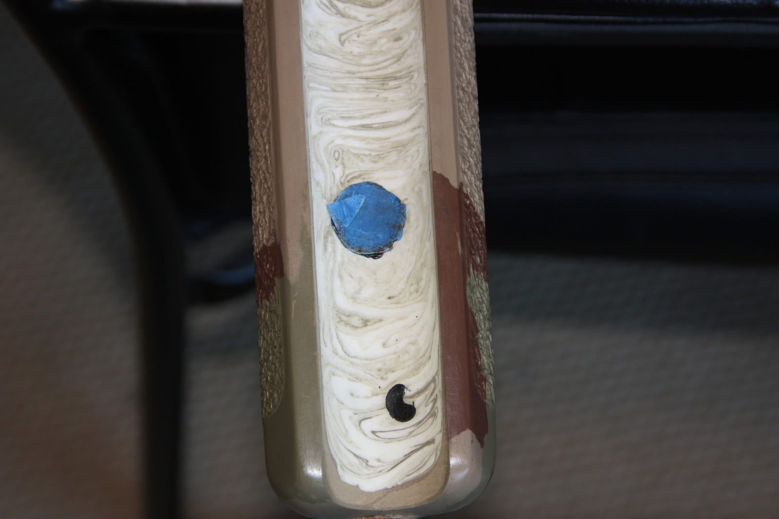

Top left was 3 shots after I got it zeroed. Working right to left, top to bottom, it then shot a 1.1, 1.2, 1.1. It then shot a .34 with a called flier, but the center of the group started to walk right. Next group was a .84 excluding what I felt was a flier... possibly both were, but again the group moved right. Last group had some slightly sticky bolt, the group def opened up, but was even further right.
I decided to take the stock out and check the bedding as it seemed to be free floated by the barest of margins... this is what I found.
The blue spot is masking tape... there is a piece on top that was just sitting there taped down. This touches the barrel and there is a slight wear mark. under the tape is more tape that is hard and seems like it was epoxied down.
The black thing nearer the front I cannot identify. It is very hard and seems to be embedded in the filling material (seems like some kind of high density foam.) It has a very noticable wear mark on the barrel.

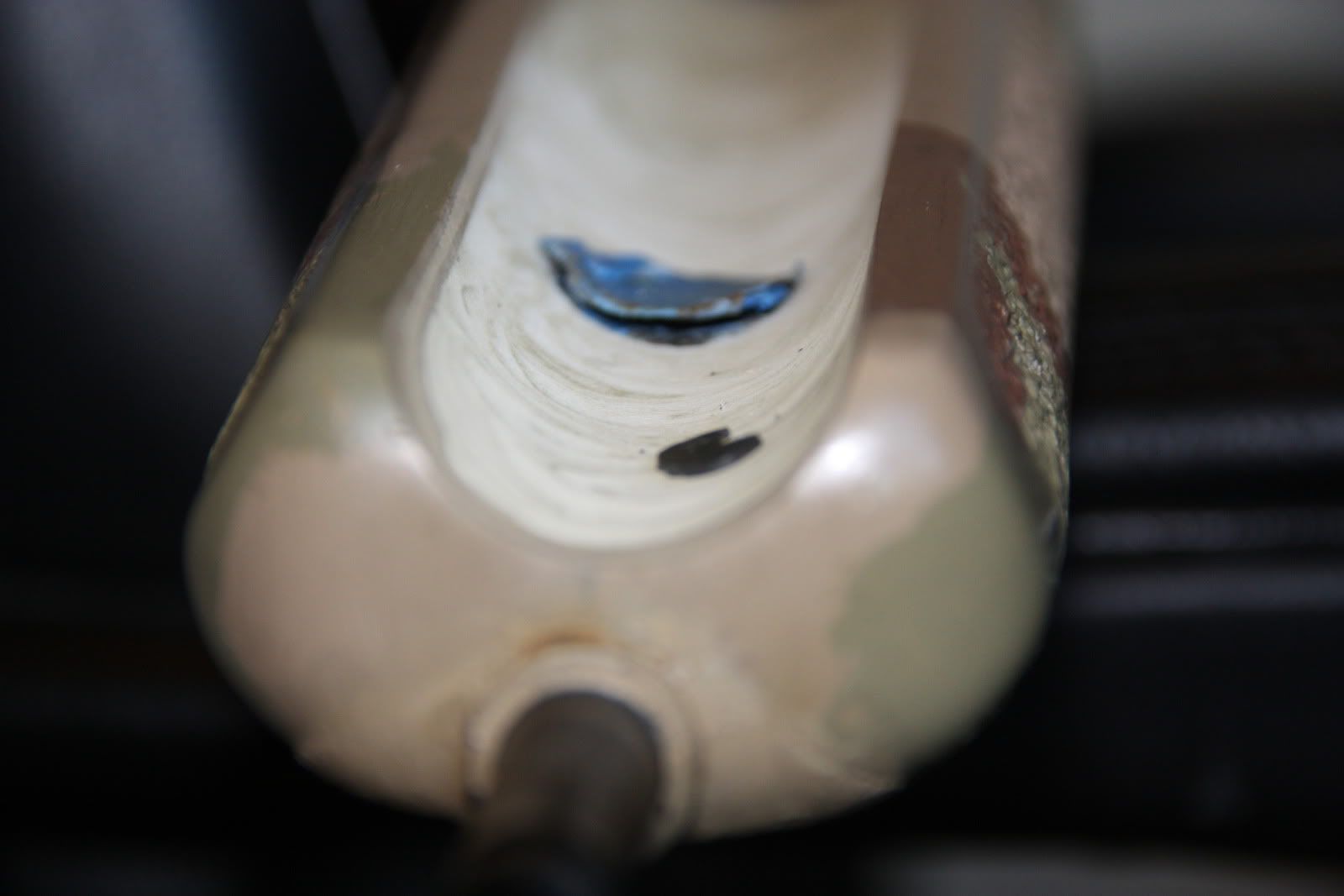

A possibly better pic:
What is this thing? Did someone try to tweak the rifle with some tension afterwards? Should I take it out? Is it possibly/probably why the POI was walking right? Mounts/bade are fine. Scope is brand new so may have a problem that I don't know about yet.
Thanks in advance.
I could see the barrel harmonics being affected by that material touching the barrel. I would remove it carefully. That black glob looks like epoxy that dripped and got left there? The blue tape may be covering a factory hole left by removing a swivel stud. Is there a stud still on the bottom of the stock under that tape, or does it look like it has been filled?

I think there is a lug of some sort under the blue tape, maybe to do with the versapod. If I take the loose piece off there is more blue tape that has been epoxied or something, if I take the loose piece out it won't touch tho.
The black thing could be epoxy now that you make me think of it... it's kind of embedded into the foam filler but epoxy would eat that foam up to some extent probably.

I would wrap some sandpaper around a dowel and just sand the forend open so there is about 1/8" between the barrel and the forend. Space is good.
What you may be seeing, if not the cases or on top of that, is the barrel hitting the stock depending on the load causing flyers. If the action is well bedded, you do not need any forend pressure.

Definitely check the bedding and make sure that action is well fitted to the stock. having some support under the first 1" of barrel is not a bad idea either.

That is a screw up, clear it out so it floats. Space is good. No one plays with "pressure points" for accuracy any more. That is done by some factories so the barrels line up in the channels when the barrel is crooked or the stock warps.
You said this was a G.A. Precision rifle? Mmmmmm.....
Thank you all, it is out now. The rest of the bedding is very clean so this may be someone playing with it at a later date or something.
