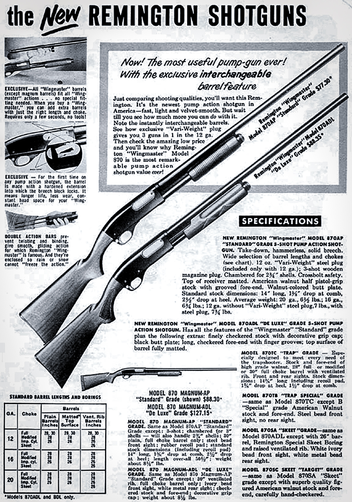

The date code on the shotgun puts it around February of 1968.
The barrel measures 26.25" from bolt face to end of barrel. This era of shotgun came with 26" or 28" barrels. I'll try contacting Remington and see if any record show the original configuration. Doesn't make sense to put improved cylinder choke on a full choke barrel?
Never heard of (or seen) a Wingmaster with a 26" full barrel. Not that they couldn't have been made, everything is possible... But...
- it was fairly common to cut down longer barrels and install Poly chokes... To make the firearm more versatile... And in this case, if the guy was mostly hunting grouse, it would have been much cheaper than buying a shorter barrel with a I/C choke
