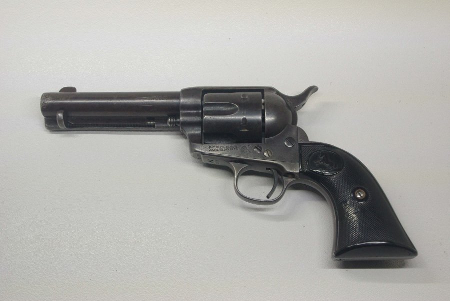

Colt SAA: the hammer has to be cocked by thumb. No other option.

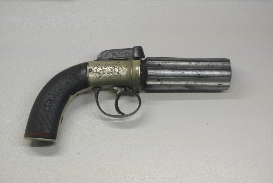

Bar hammer pepperbox: the trigger has to be pulled through to make the hammer rise and fall. Still a single action, and no other option.

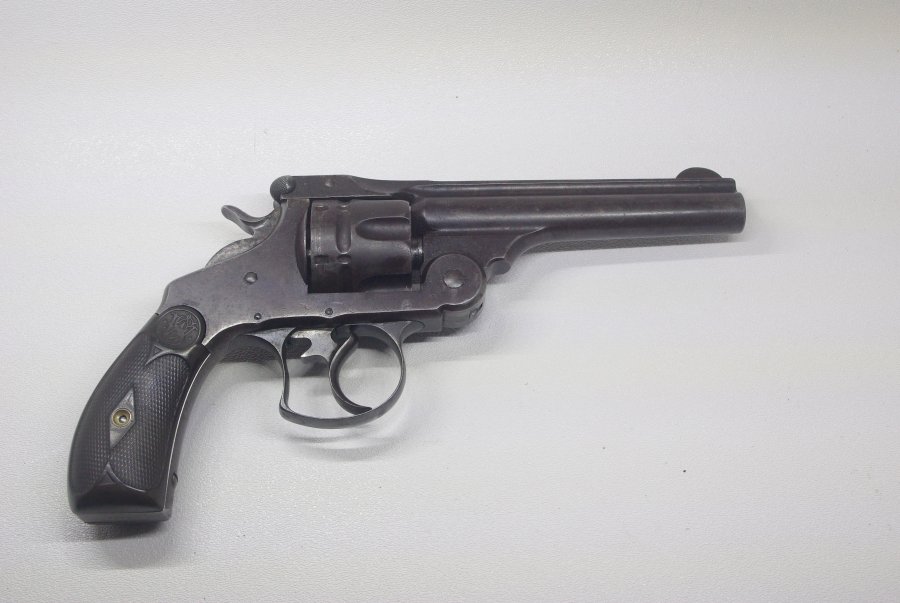

Smith & Wesson 44 Double Action: the gun can be fired either by cocking the hammer with the thumb, or by pulling the trigger through. True double action.
