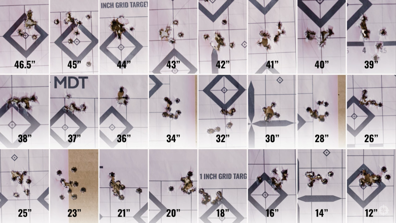

Confirms the 16" length concluded decades ago in another similar test. What is very interesting is how groupings change, probably due to barrel harmonics. 44, 36, 30, and 20 appear significantly tighter.

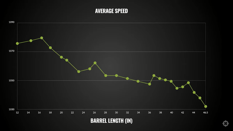

... lengths OVER 16" decelerate the 22lr...

Confirms the 16" length concluded decades ago in another similar test. What is very interesting is how groupings change, ...
... One group is meaningless.
... Certainly not scientific, but entertaining and provided some high level information that might be useful to some.

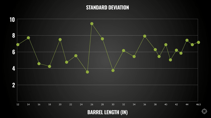

The MV data is useful. The SD and POI shift data is potentially useful. Unfortunately, I think putting the group sizes in the video makes it pseudoscience.

With regard to the video/test, in what way is the video/test MV data useful? What relationship, if any, might there be between SD and POI shift? ...

The data in this study is pretty noisy. Increased sample size would have been easy enough to do, and may have smoothed things out. And because of the methods, I have serious doubts about reliability. But in my opinion, just because it's not perfect (or even "pretty good") doesn't necessarily mean it's entirely useless.
I think the MV data is useful in that it clearly shows a relationship between barrel length and MV. And it (probably) shows a peak MV at 16" barrel length (for this ammunition, in this barrel). It's not definitive, and it's nothing new, but it does confirm similar observations from other datasets. And I certainly had very little idea what MV was going to be out at 30" or more of barrel length, so that was interesting (even if academic).
I have nothing to say about a relationship between SD and POI shift - I was noting that they are each (individually) potentially useful. I found it interesting to observe that in general the SD did not show an apparent relationship to barrel length. And while I don't particularly care about POI shift, I'm sure others do.
