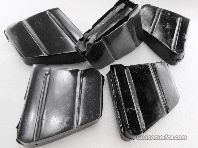

Seems there are two types of pro mag
1) This has two latch grooves..
enfield-4-mk-i-303cal-10rd-blue-steel-magazine_81ca8301-fd2f-4e29-b13c-422ab567d591__75377.1537508016.jpg
2) This one is a sheet metal cut out notch.
The geometry of the lips on both of those look wrong, maybe it's because they have a removable floor plate, but they don't really look like they'd feed without a lot of work. I have a No4 and a No5 and both mags are serialled to the guns.
