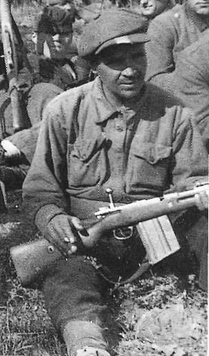

what is this?
Gew 98
Hello,
Hard to tell with out seeing the entire rifle. It looks like it could be a Gew 98 with a 30 Rd Trench Magazine on it. I know they were made in WW! but how a Russian got one in WW2 beats me.
Cam
Cam_S said:
I know they were made in WW! but how a Russian got one in WW2 beats me. Cam
My guess is he took it off a German soldier's dead body. Part of the spoils of war I guess.
My wild guess would be a mauser(no bolt cutout) modified to fire russian ammo
and using a mag from a russian machine gun. They were desperate for guns at the start of the war and armourers probably made all sorts of field modifications.
The mag might not even be removable. The great thing about milsurp is the story behind the rifle, and there is definitlely a story behind that photo.
Look too much like a FN FAL type mag to me.
Scale is perhaps too big for 8x57, and for the mag well.
It just could be a FG42 mag grafted on to the picture.
Hard to place, but the shadow and light looks off. It may be a reflection, can be hard to tell from old B&W's. And it does look awfully like an FG42 mag.
I can't *possibly* imagine the Commies shopping pictures to give the Germans the idea that they were more heavily armed than they were! :rolleyes: It would be inline with that kind of propoganda
It is definitely NOT one of the WWI long magazine extensions for the Gew. 98 rifle. I have one of those, and it is nothing like this. This looks far more like some type of MG mag, likely ZB, grafted on. Would be a lot of fun at a pin shoot!
Czech looks right.

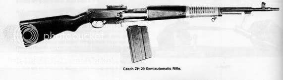

ZH29 , mag also used in ZB26 and ZB30
Numrich arms have been reproducing these 20 round, Mauser, Gew 98, magazine that was used by the germans during the WW1 trench warfare.
However, the picture of this particular magazine suggest it to be from a czech ZH 29 rifle ? The copy of the original 20 round, Mauser magazine, as found in the "Numrich" catalog, looks somewhat different.
The magazine on this rifle is, as has been shown, from a ZH-29.
