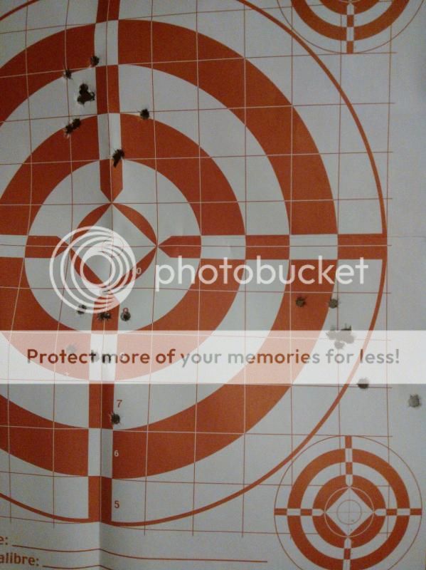

S&W M&P 15 Sporter, 55 gr V-Max, W-748 (I can't remember the charge...I'm look'n), 100 yds, 10 shots pre group..
What do you think?
Most of the ARs are 2moa on average with good quality non match ball ammo. If a particular rifle likes a particular ammo, it can do better than that, and vice versa it could go all the way up to over 3moa.
