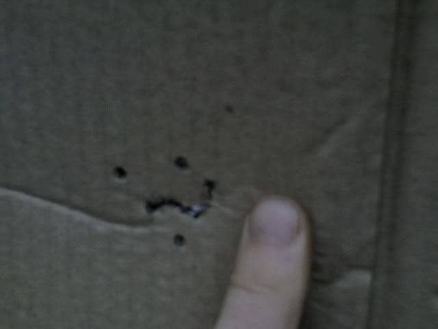

I own the 93r17 BVSS, and its my most accurate gun.. Had about 7 people out for a shoot one time and they were all pretty impressed with it.. The barrel has been free floated, but thats about all. Ammo isn't all that bad, alot more expensive then 22 ammo for sure. The caliber gives you alot more range though

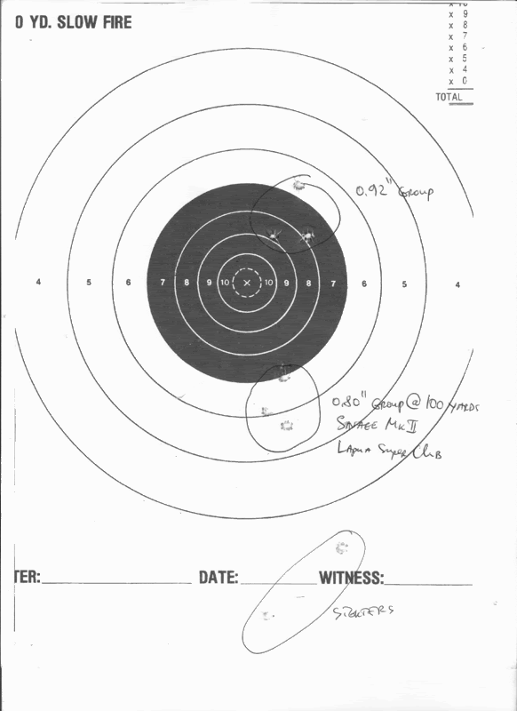

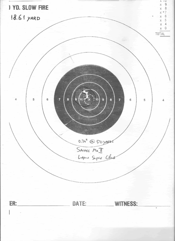

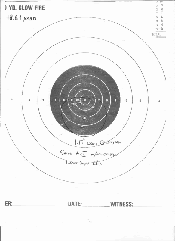

I have no complains regarding Savage MkII accuracy, it has won almost every informal local match in our little club. Below are 100 yards random groups pictures collected over some time, not the best groups but rather representation of what you will be getting in your every day shooting
three different groups on one target at 100 yards - I was practicing holdover for annual hunter shoot
50 yards

As for groups, I just know that they were under an inch, I didn't bother to do any specific measurements.. I was just curious to see whether it could shoot under an inch.
