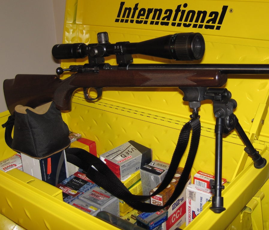

Starting to shoot 50m and 100m with my CZ 22lr Lux and Bushnell Legend Ultra HD 4.5-14x44 scope, I need to be steadier than using the odds and ends of supports at our ranges. What should I look for in a bipod? And should that always be combined with a rear bag?

Harris fixed bipod gets my vote for bench shooting. Yes, a rear bag helps too.
Sounds like a great set up, OP. May need to raise your cheek on a lux to get solid weld.
My recommendation would be either;
1) Harris Bipod (Type "S") with a rear bag (I use a Protektor and love it), or;
2) A pedestal type front rest with a rear bag. This is obviously a more expensive option, but if you are after tight groups and mostly shooting at the range, it is a sound investment.
I have both options, so feel free to pm me for pics or with any questions.
