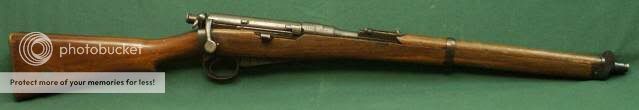

Well, I was tasked with doing a complete inventory of an Artillery Regiment's stores, and I came across one of these tucked away in the weapons vault along with a couple minty Snider-Enfields. They belong to the museum that is also in the building...
I had my cell phone handy, so I snapped a few pics. Sorry for the quality.
What struck me was the 5 round magazine, which was attached to the mag-well via a link of chain, and the front sight cap. The reciever was dated 1896, and she still had the dust-cover for the bolt. The parts were covered in cosmo, as was the bore... which appeared to be in good shape.
Is this a calvary/artillery carbine of some sort?
I forget the make... but if I recall correctly it was a BSA.
Either way, you don't see this every day. Hope you guys enjoyed.
Tyler
Check on the Knox-form of the barrel (the flat directly above the chamber). If it has an "E" on it, it is definitely Enfield rifling. It SHOULD be Enfield rifling..... but, one never knows.

BTW, that's an original 6-round mag. The chain is correct on Carbines and on older rifles as well. Spares were NOT issued and, as far as the Carbines are concered, they were issued to the Cavalry, and you really don't want to try remiving a mag from your rifle and reloading it and then replacing it and cycling a round.... at a full gallop!

That is one nice old lady. Hey, if you have a chance, could you take a picture of the left side of the butt socket?

Yup, looks to be a LEC cavalry carbine, a nice one too! Sadly, somebody sanded the wood to clean it up. Make and model will be stamped into the metal of the left hand side of the butt socket. Likely a Mk.I*. Only Enfield made the military contract carbines.
I have penchant for these, I own five of them in different stages of restoration, including an early trails carbine.
Lou, if you are good at whittling, a passable wood set can be made from one taken from a sht LE.

A 6 round mag! Never knew... What did they use for chargers back then?

Spare mags were issued, but were kept in the soldier's kit. Only serjeants had the tool to expand the chain link and change the magazine.
Missing the cleaning rod, and the markings on the butt disc look Greek or something, but still a rare piece.
Heavily sanded down too as mentioned.
Clearing rods were removed from service right about the turn of the century (exact date eludes me right now) but the fact it is missing it is not surprising, and by that fact alone means the rifle is correct without it.
