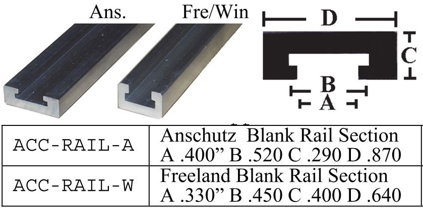

I did search chatgpt but the rail doesn't look like either of these, can't find anything that looks like it. From wiki, the anshutz on the left and freeland on the right, both with very square cuts. I found some info on 11mm dovetail, just not sure if that is a possibility
My artistic attempt to capture the shape of it. I recognize that a square edged slide could engage in that groove, I just want to be sure i get the right adapter.
Check your "B" dimension:
It is not uncommon for Walthers to have the inside of the UIT rail to be curved like this or even more:

Only way to be sure is measure the dimension of "B".
B dimension is 12.3mm or so, hard to get exact, the calipers are cut so they don't get in the groove perfectly. 12.3 is 0.48" at the deepest part of the angled groove.
