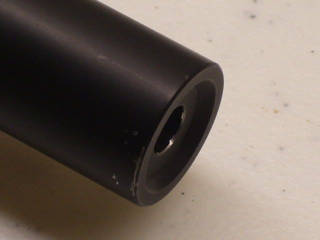

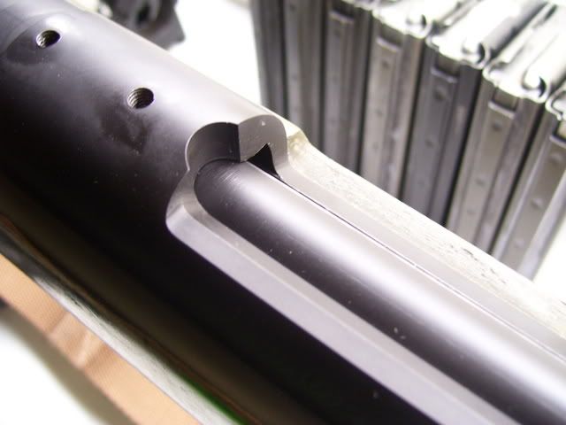

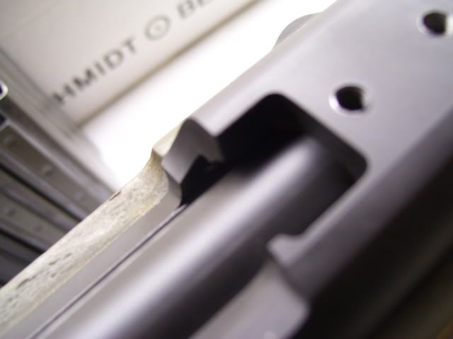

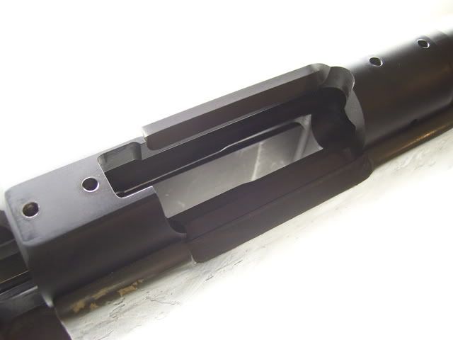

- Rem 700 action, slotted for the DD Ross 30MOA rail (which will only fit the action after the correct cuts have been made to the action. The M40A3 receivers were only slotted to accept the DD Ross rail, they were not clip slotted like the earlier versions). The actual USMC rifles were said to have been built on "G" prefix Reminton 700 receivers if your into hunting for one (if they were ever availble to the public, that I don't know).
- I can't remember what the spec on the recoil lug was, perhaps someone could chime in (I think it was also DD Ross).
- Barrel: Schneider barrel, contour #7, 6 grove, 1:12 twist, Length 24" from recoil/ 25" from thread to muzzle
Start at 1.250" and muzzle end at .920" ***(The Schneider USMC contract barrel may be very hard to locate, a Rock Creek from ATRS would be a good substitute).
- Crown: 45 degree recess with .090" depth

Here are a few pics I found of a receiver slotted for the DD Ross rail and the spec crown.
